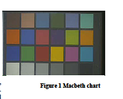

The Beeb, carefully disowning image quality of these pictures I snatched from their "reviews" do offer, for my kind attention and yours' please ... Sorry about the mismatch in sizes; big= XHA1; small= V1

Brendan - just as a caveat, my comparisons were done on paper (well, in a spreadsheet) listing the features one by one, it wasn't a physical comparison: I have never used a Canon XHA1!
From anecdotal evidence on this forum and others, and looking at sample clips posted here, I feel they're both very good cameras. If you search, you'll find a lot of V1 versus A1 questions posted and very little concrete evidence to say one is better or worse.
Picture quality is hard to compare (at least for me). It has been said that the Sony has a "cooler" image and the Canon is "warmer", but even that can be tweaked with picture profiles or in your editing software, and in the end I chose based on physical aspects rather than image quality.
