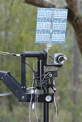

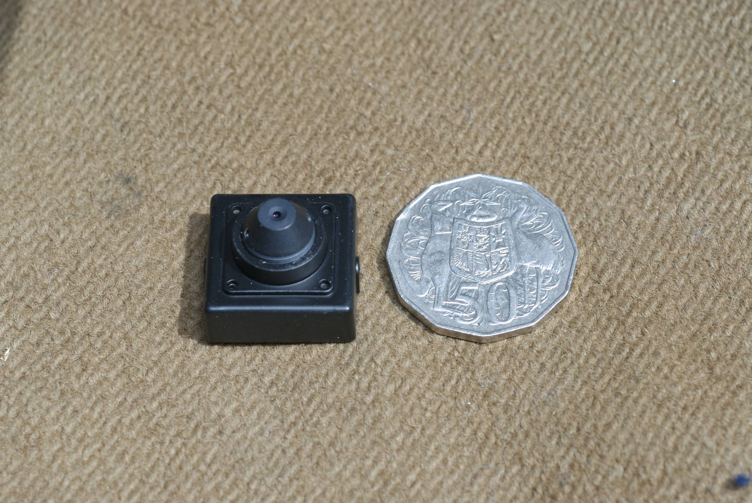

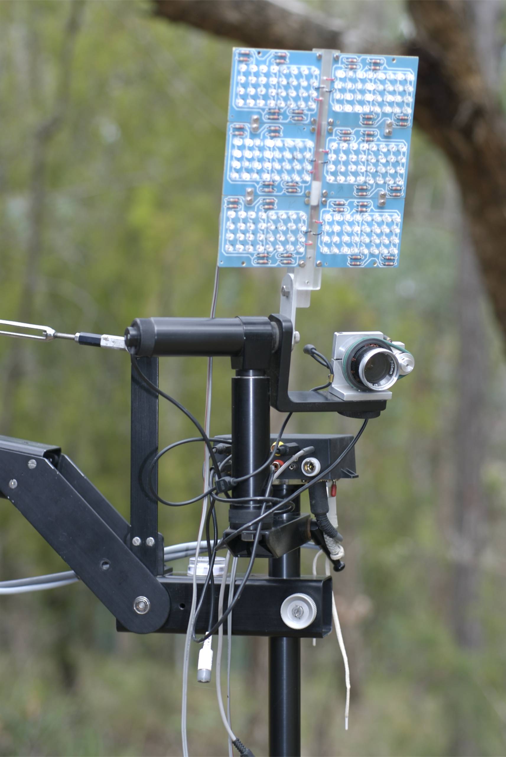

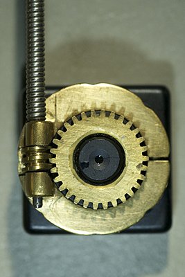

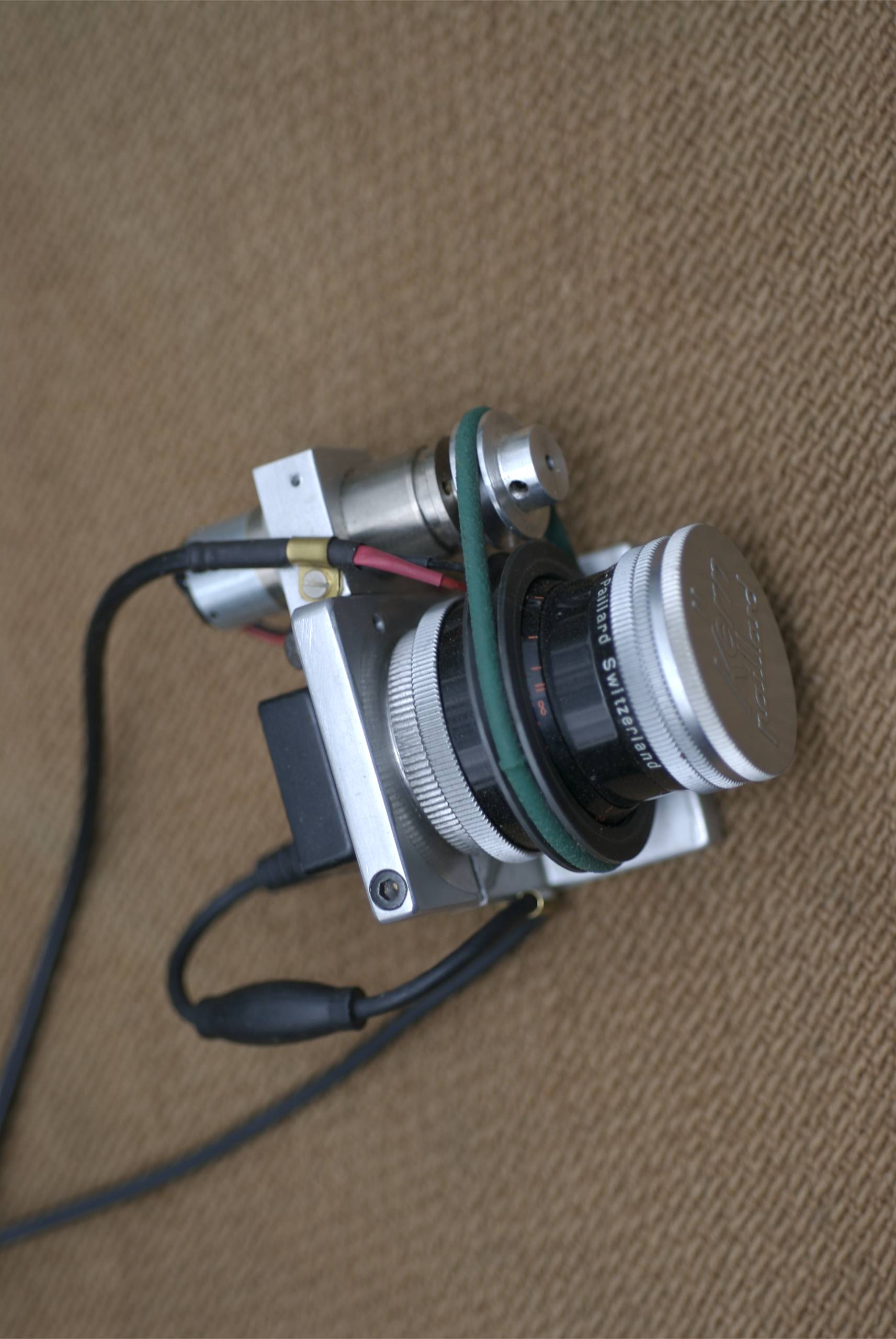

I have downloaded some old stills that may be of interest. One shows a 25mm x 25mm camera as it comes, another shows the camera with a focusing mechanism added, one of these was used to record a platypus in its underground nesting chamber (not by me), another was used to record a Tasmanian devil in its burrow (again not by me). The platypus nest was located by radio tagging a nursing female and radio tracking her to the nest. Then a hole was bored into the chamber and lined with a plugged plastic tube. Every now and then the plug would be removed and the camera would be lowered down the tube to see what was happening. Another picture shows one of the cameras fitted with a ‘C’ mount lens and motorized belt driven remote focus. The final picture shows the same camera mounted on a ‘hothead’ which in turn was mounted on a boom supporting some infrared LED panels. It was used to record a feeding phascogale (by me).
The LED panels were only available in kit form at the time. There is a wider choice available nowadays

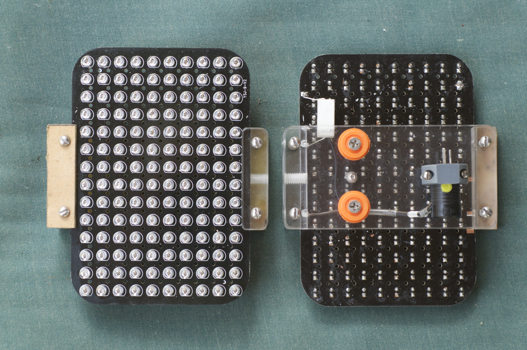

Thanks for the information. I now have 4 lamps that seem similar in power consumption and external characteristics to your IR-294S/90 To save bulk and weight I have removed the panels from their housings and I am in the process of making mounts so that they can be used individually or ganged together. I have also a couple of IR spotlights. I hope that at last I will have more than enough illumination.
