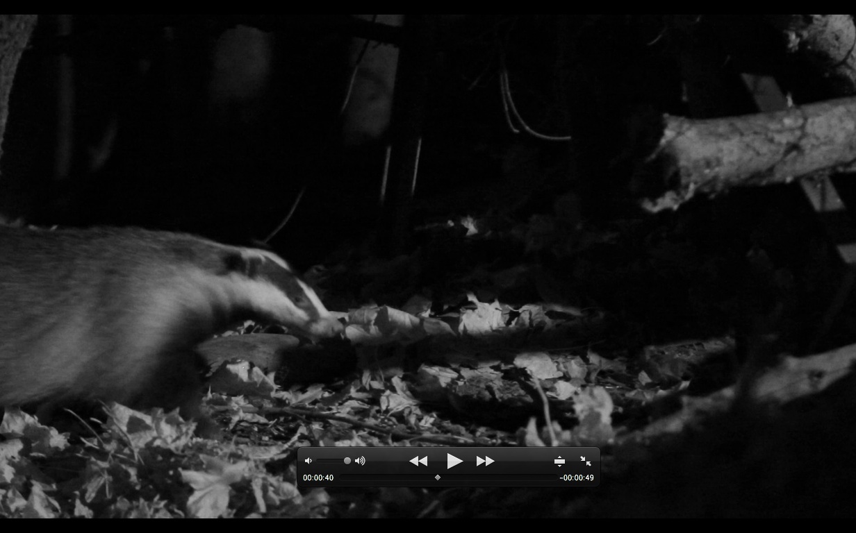

I am using a IR converted 550d to film badgers in an urban environment. Providing that the subjects are well lit then the results are excellent. Lighting is key. The advantage with a converted DSLR is that you are not chained to an external recorder and you can be very mobile.
I am using 3 IR illuminators, cheap ones bought online. One is an IR 60 degree floodlight, plus two small IR spots (30 degrees) to punch light into the shadows. They all run off a 12v motorcycle battery which runs them for a full night. There are better lights available but these are expensive.
The whole kit goes into a camera rucksack (naturetrekker).
