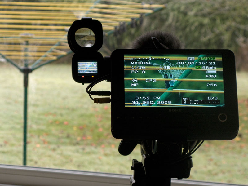

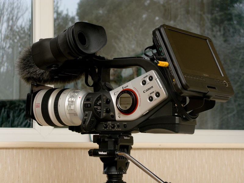

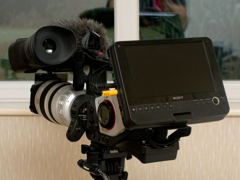

This is my solution for attaching Sony's DVDPlayer to XL2.
Focusing is easier, zebra doesn't work, to check it you have to use viewfinder.
This set-up makes camcorder really back heavy compared to naked cam witch is much better than supporting front heavy brick lifting massive lens with the hand all the time.

Elegant! That eliminates most of the instabilities from a mounting bracket. If you have any closeup pix of your mounting, I'm sure we'd really like to see them.
