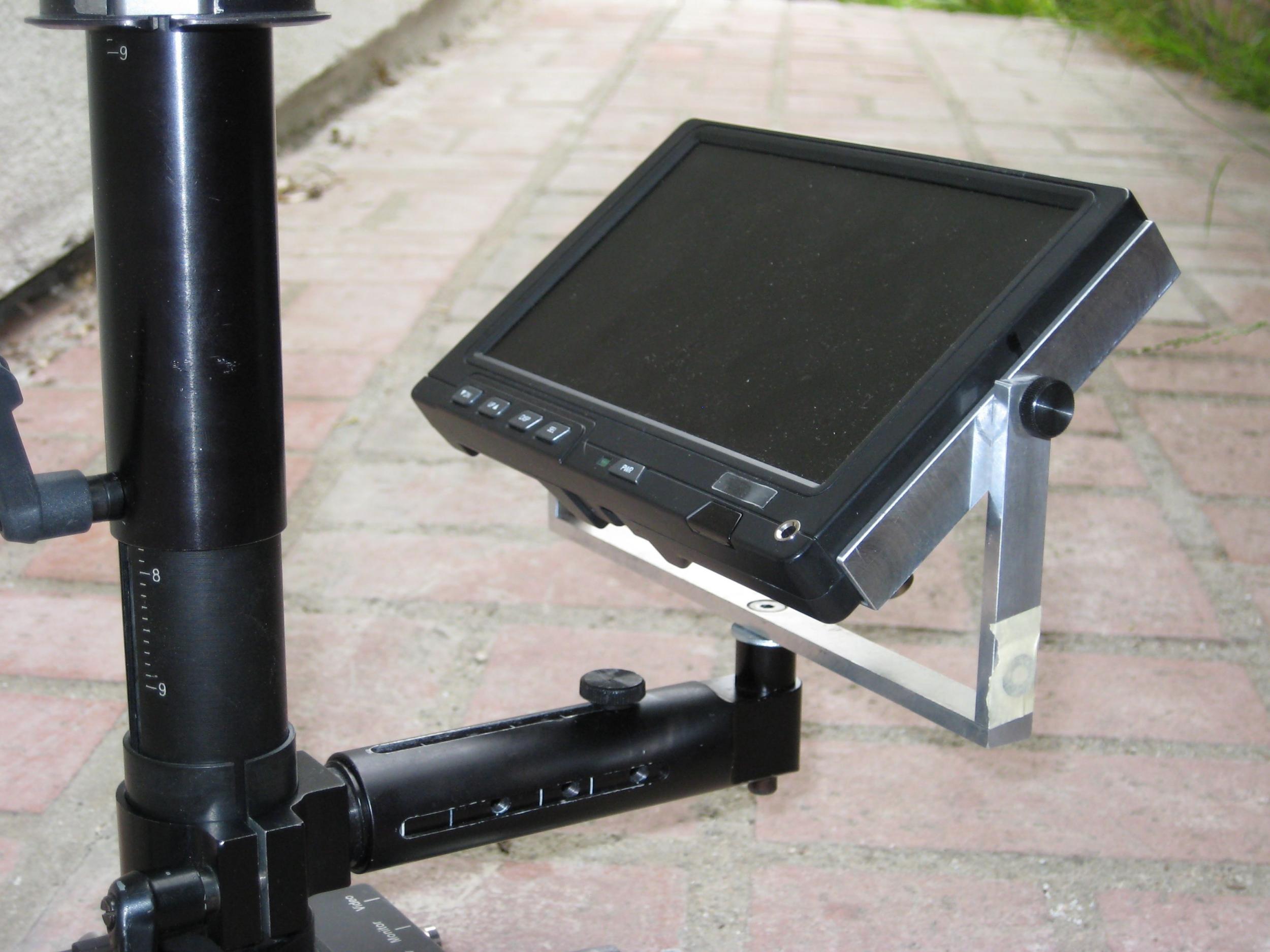

If you are looking to put this on a stabilizer, I'd recommend (just from the pix) the U-bracket accessory on the Small HD site. A yoke such as this is the best way to mount a monitor on a Steadicam as it allows for tilting on the center of gravity (I'm assuming here the side threads are at the CG...?!) which maintains the balance of the rig as you make adjustments. Ideally both the tilt and pan pivots should integrate spring washers so that you can make those adjustments without having to loosen or tighten knobs.

One more point I will make about this: LCD monitors have a limited vertical viewing angle, and thus through the act of booming through the range of your stabilizer you can lose sight of the image as it "reverses". It's helpful to pre-set the tilt of the monitor for a given shot to minimize this effect for the majority of the shot. With a yoke as I described, you simply reach down and adjust the monitor and keep shooting. With a ball mount, Noga arm or the like you need both hands to make the adjustment, which is obviously tough while wearing the rig, plus you have to tweak the balance afterwards. Not good.
(attached: Steadicam Flyer monitor that I had modified with custom yoke)
