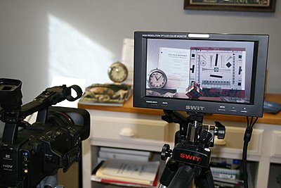

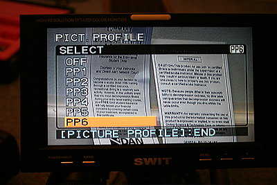

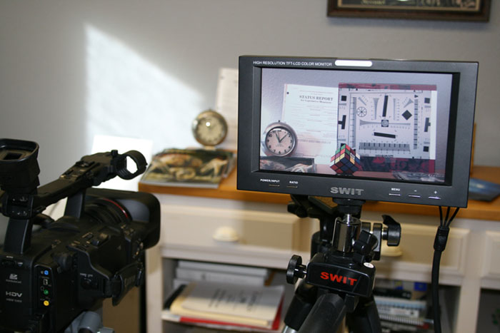

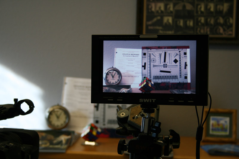

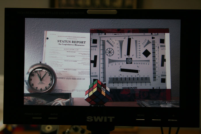

Ok. I don't have a lot of time for this sort of thing, but I gave it a try.
The HD (800x600) monitor described above hooked up to my A1 and pointed at some stuff. I printed some resolution chart I grabbed off the internet, it was like 3,000 x 2000 pixels and printed it on photo paper . Added a few other things. Now, the weakness in this test is that I am not a very good still photographer and this was just set up quickly in my office. Sorry, but that's the story. Now, the shots I snapped look a tad softer than the monitor looked with my own eyes.
Take it for what it's worth. I like the monitor. I can see hair and pores on someones face when I Zoom in a bit, so it works for framing and focus. Colors seem reasonably close.
Oh, the A1 was set to factory and zoomed in to 40 and the aperature was somewhere in the 4.0 range. 30F 1/60 fps.

I used the Varizoom for a shoot yesterday and the framing is spot-on. Lighting seemed acruate to the A1's little screen and then what I saw on my editing monitor later. Overall I am pleased with my purchase.
That being said, I have not used the monitor outdoors yet.

Devon, Thanks for doing the test! I think the pictures could be a little bit bigger though to get a better sense of the resolution. And it’s important to note that the colors look flat because of the color temperature of the monitor right?
In the days since my last post there's been some mix up with an order I placed and then canceled in December. It turns out they sent me the Varizoom Swit that was at the time not in stock... even though I canceled the order. It's going to go back but only because in the meantime I found a Marshall HDA used.
But it allows me to make my professional assessment of the device... I think it's a pretty decent monitor overall. I also haven't used it outside, but inside at the right viewing angle it's very sharp and clear and even quite pretty. The colors seem as you say close enough (MUCH better than the 5.6” LCD I mentioned) and you get good feedback on framing focus and exposure.

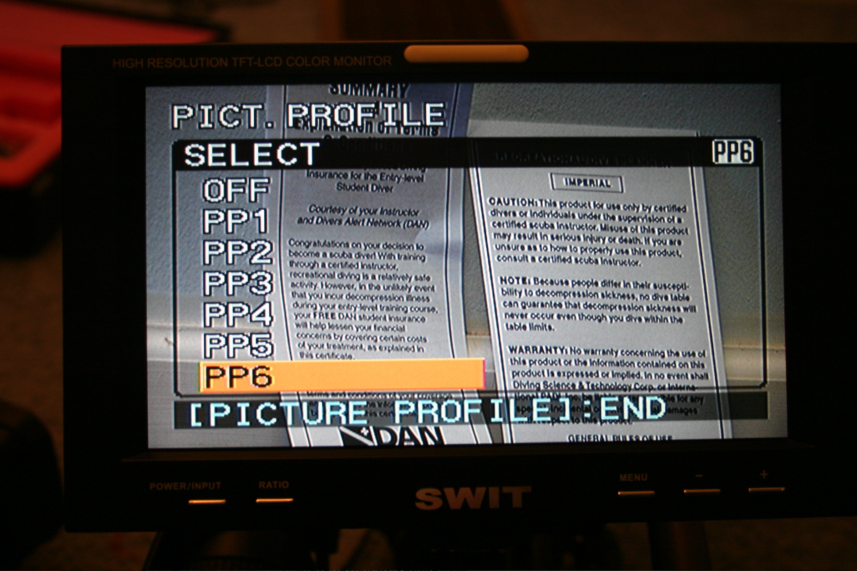

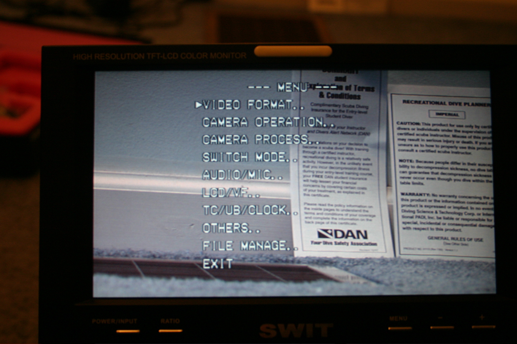

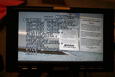

SWIT problems in YUV mode
Well I got the BNC adapters today and I think that either they are really bad quality or something is wrong with my SWIT. The sharpness is lost entirely when using the component hookups. It is smoother that S-Video and has less aliasing for sure, but it's too smooth. I was pretty shocked to see the perceived resolution go down.
I uploaded some pics to compare.
What is also very strange is that you don't have the Sharpness control option on component and you do with S-video. You can crank it up (which helps in focusing) or turn it back down to a reasonable level. But no adjustment can be made in YUV mode. I found it very difficult to focus with it in component.
Finally, when sending a 480p signal over component there is an obvious defect as seen in the on-screen text of the photo. I tried multiple cables and even swapped out all 6 BNC adapters that I got, but it was always the same - at two parts on screen there are what looks like field doubling or some such thing. It's not present in 720p.
The adapters I got were these: http://www.partsexpress.com/pe/showd...number=090-400
Does anyone know if they could be the problem? If not, then I would hope that my SWIT unit is defective because it's performing pretty poorly at this point. Also, sorry that the frames between the two cameras aren't quite the same. You can still see the difference in the camera-generated text.
Devon, do you have an S-video source you could try? Any difference? Just trying to get to the bottom of this.
