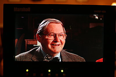

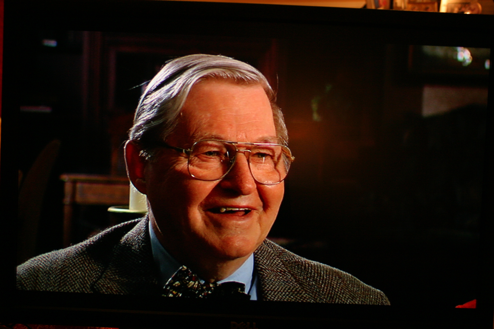

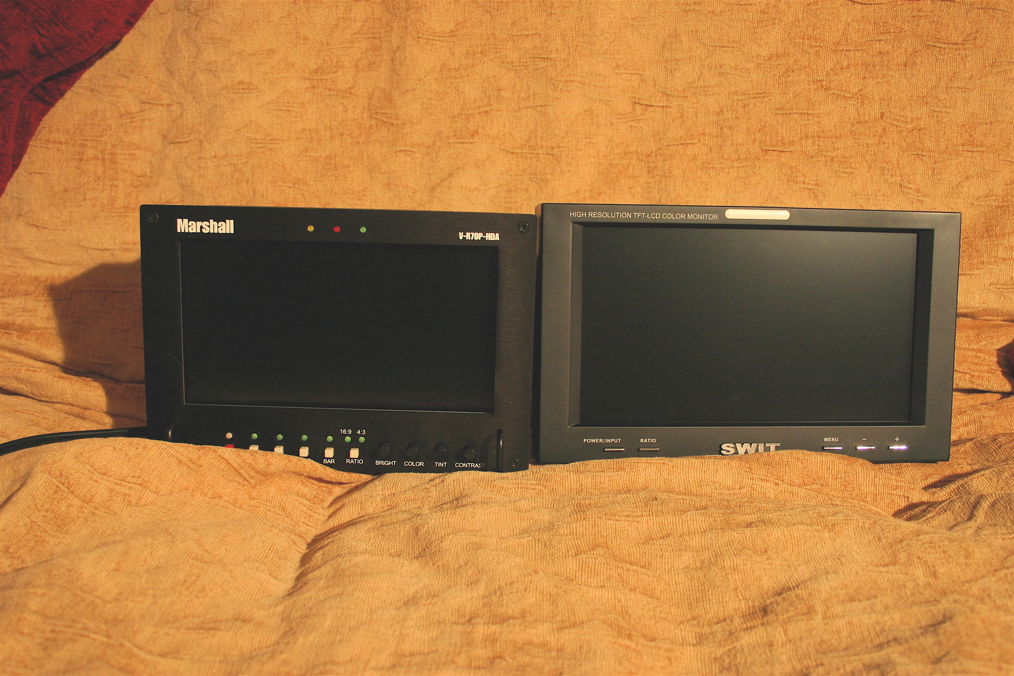

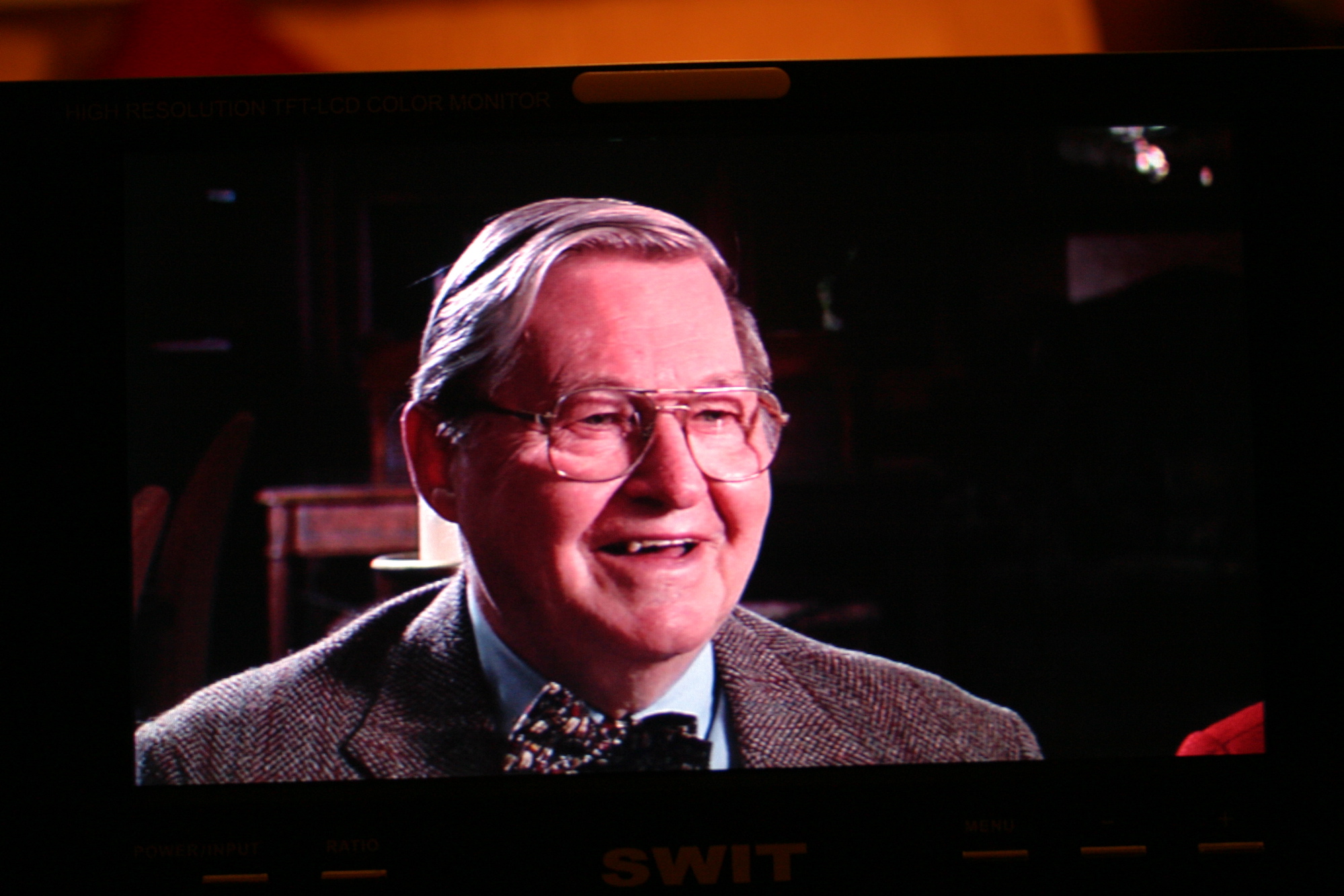

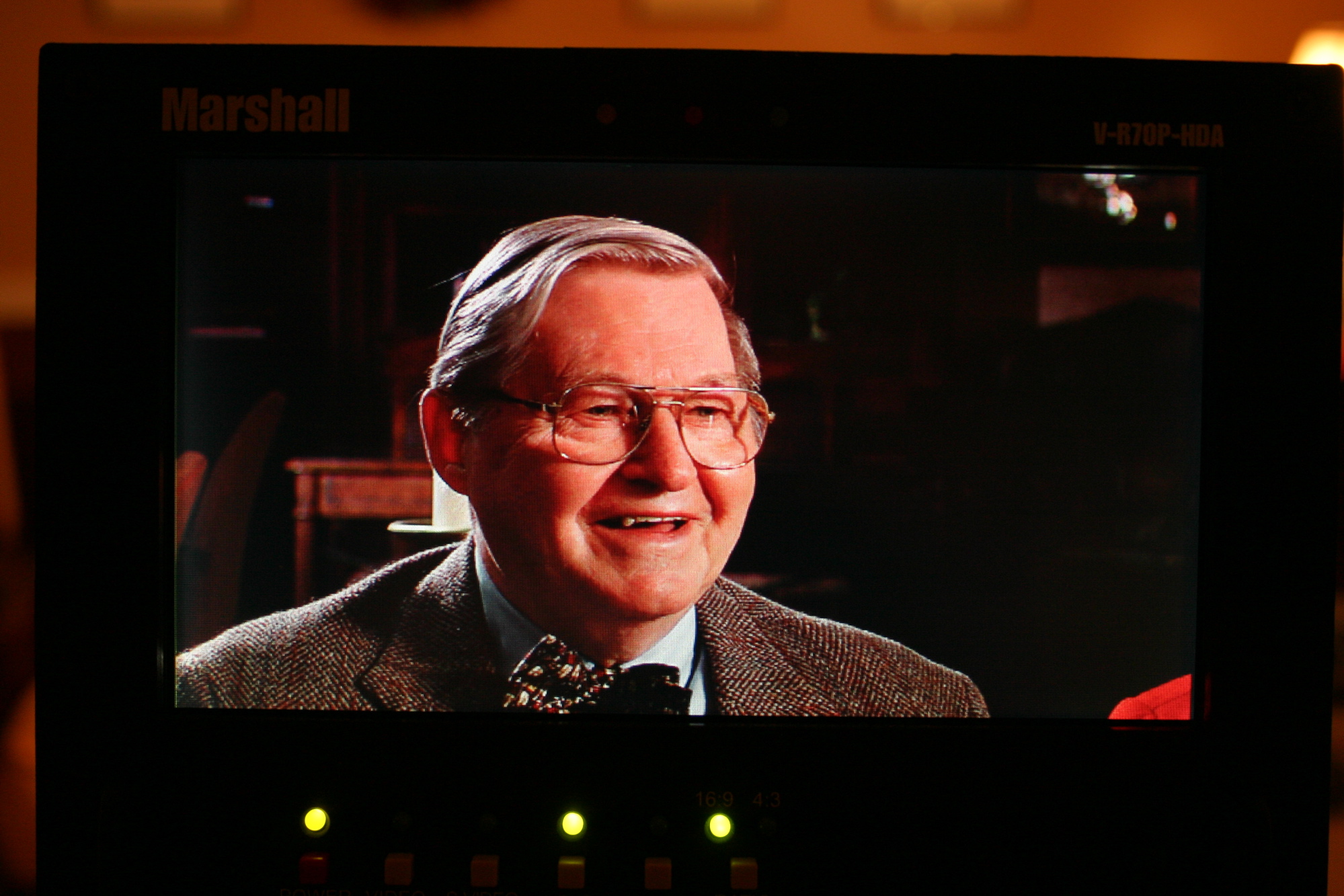

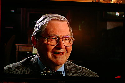

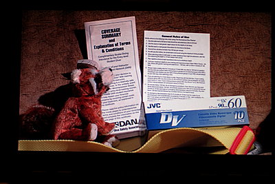

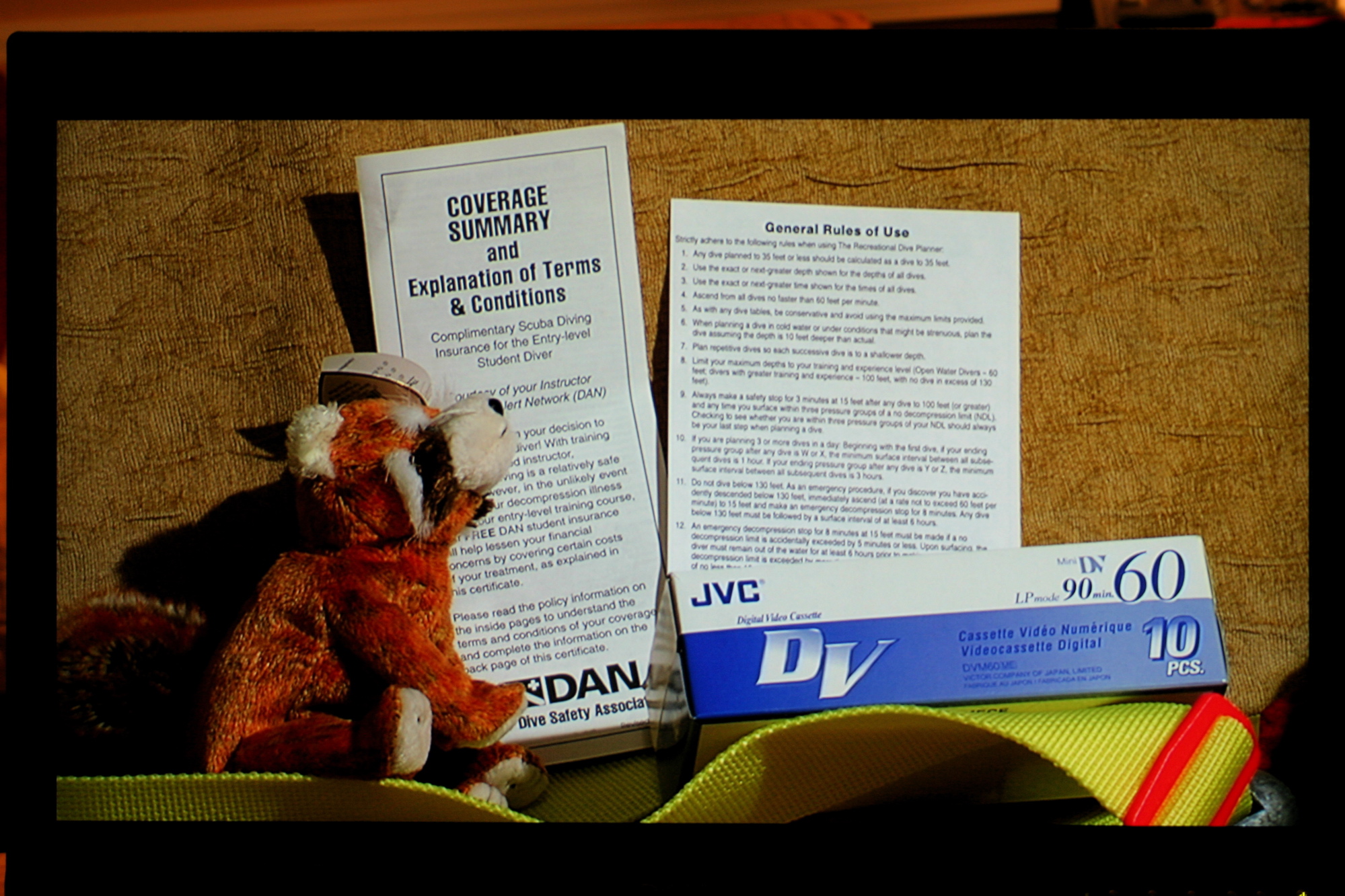

For those still interested I got the Marshall and shot a few comparison photos. I still don't know if there is something wrong with the SWIT they gave me, but if not, then I'd definitely not recommend using it with component. I could not tell focus or color (though this is adjustable with sliders) It's much better in S-video (even better than the marshall in S-video).
But the Marshall with HD plugs looks the best of all. I only wish it had some kind of peaking or zoom so that you could better see the focus. It’s there, but it's not as hit-you-in-the-face focus as I was hoping. You still have to get your face in there and look hard. But you can tell when it's sharp because it has some aliasing on the edges (so I guess this is a little bit of peaking).
But it's still a pretty monitor and will certainly come in handy for adapter work and everything else (though I'll be relying on my Dell 24" as much as I can because it does give hit-you-in-the-face focus feedback).
The good things I can say about the SWIT are:
1.) Size (that extra inch may not seem like much but it really is helpful for comfortable viewing. If only it were sharper…),
2.) Weight (the Marshall is bulky and heavy),
3.) Price. ($500 less with accessories = considerable amount),
4.) Image flip (it's handy).
I do have one question for those who know more about this than I do. I'm getting some horizontal lines on the Marshall when using it in HD or composite with my JVC HD100. They scroll from the bottom to the top of the monitor about 1 inch apart. It's crazy annoying and I don't know where it's coming from. There's no problem when I view component output to my Dell monitor directly (but it transfers through if I go through the Marshall outputs). I tried getting some "better" adapters at Radioshack -same things, but gold. They didn't help. Could there be an issue with the BNC adapters still? Would something like this be better: http://www.bhphotovideo.com/bnh/cont...goryNavigation Or should I be calling JVC? Thanks.
Here's the photos:
Varizoom Swit vs. Marshall HDA-face-dell.jpg   Varizoom Swit vs. Marshall HDA-face-marshall.jpg
Varizoom Swit vs. Marshall HDA-face-swit.jpg   Varizoom Swit vs. Marshall HDA-scene-dell.jpg
Varizoom Swit vs. Marshall HDA-scene-marshall.jpg   Varizoom Swit vs. Marshall HDA-scene-swit.jpg
Chad Terpstra is offline   Reply With Quote
I never experienced this problem with the HVX200 (in any mode). Know anyone with an HVX? It would rule out the connectors. I'd guess that it's cam. setting, but I know nothing about the JVC.
Sam Jankis is offline   Reply With Quote
Old January 25th, 2007, 06:59 PM   #43
Location: Wyomissing, PA
Posts: 1,141
Images: 57
Chad, I don't have that issue with the Marshall, and it sounds like a power/interferance issue. These monitors did have issues with flickering when used on HVX's, do a search on Marshall flickering HVX. Marshall reported it to be a calibration or power conditioning issue that was fixed. However, some users reported the problem persisted even after sending in for a fix.
You may have a defective unit? However, if your Swit was also acting up, maybe it's your camera? Are you able to hook the Marshall up to another camera to confirm the issue?

Peter, I seem to have misplaced my component hookups for my FX1 or I'd have tried that for sure. But I did try it with my DVD player via component and it gave a good clean image without the lines. I've got the LCD powered by my camera's Anton Bauer battery via a powertap to XLR cable. Here's the scoop on what I've tried with power:
On AC power the LCD shows less of a problem but the pass through outputs show the lines very badly on the larger HD monitor. BUT when I turn the Marshall off the lines go away on the large monitor...
On the camera's battery (shared power) both monitors exhibit the lines but the large HD screen less so. -Also stops when Marshall turned off.
On a separate battery both monitors look pretty clean and if anything have a faint flicker which is hard to detect/easy to ignore..
So it appears there is some sort of power inconsistency. It seems like the Marshall was intended to be powered by a single battery all by itself. I may have to rethink my power solution… Dennis, when did you say you’d have that rails-mounted battery done? ;-)
