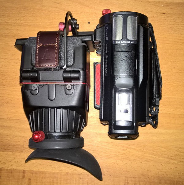

Even worse it IS my main cam during the ceremony :) I have attached a varavon loupe to the lcd screen so I can hold it to my eye like I would with a dslr. See the image I included. I also always shoot handheld with it and have a ax100 on a tripod for the readers at the lectern and the priest at the altar and just fill in the rest with my little cx730 which works for me and my paying clients.
Below is a good example of such a ceremony where I used the ax100 and cx730, check between 01:55 to 03:15 where all handheld shots are cx730 and a few stationary are ax100. There are only 4 ax100 shots in there, at 02:11, 02:36, 02:41 and 03:06
