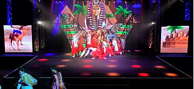

I suspect many LDs would consider the amazing colour palette now a real boon. We have Lion King = so that's amazing sunsets with reds and yellows, and maybe pinks and oranges, then of course we have selections from Wicked - so that's mega green. We can have lava and volcanos, we can have good vs evil, we can have storms - moonlight on the moors, emerald city, and amazing Samoiloff effects - which dancers love. Costumes that can go from monochromatic to snowy scenes. We can have rainbows, and all manner of mixing effects. Keep it coming. I've done two now with LED screens as background - which is stunning.I'll dig one out if I can find a suitable one.
How do you white balance dance recitals / stage shows?-img_6874.jpg
