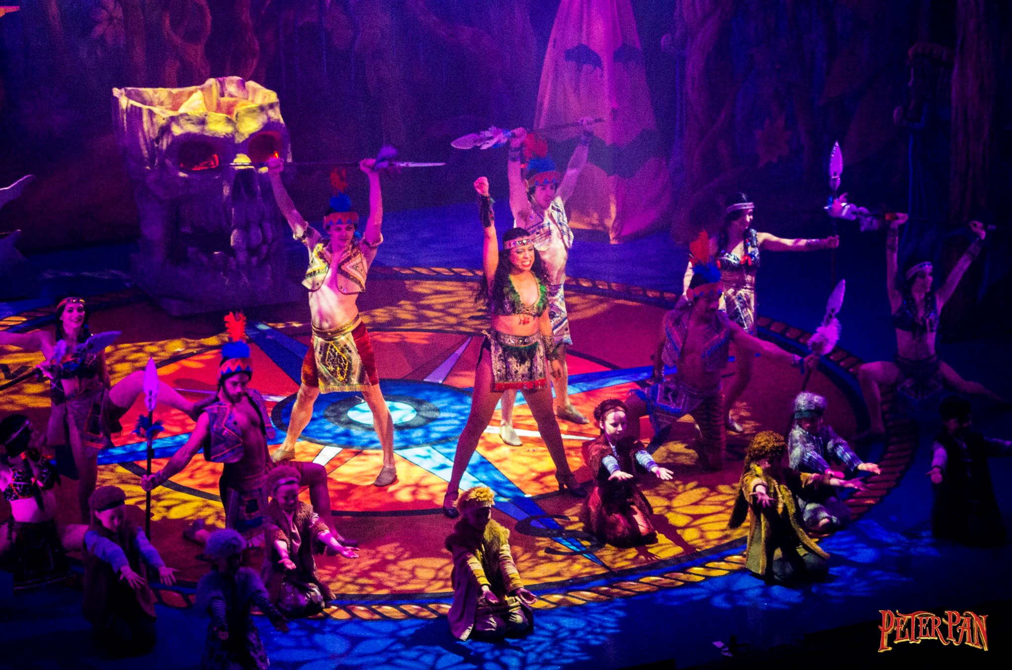

Doug - it simply doesn't work that way. I run a theatre - quite a big one (1400 seats) and while we do our own video, clients often bring in their own people, who either understand theatre or they don't.
You cannot ask me (usually in the role of technical manager) to bring up typical white stage lighting, because it no longer exists in any meaningful way. White is no longer a constant. If you stand centre stage with your white cloth you have angles to consider. The camera at the rear probably won't be able to fill the viewfinder, the camera at the side will be seeing bounce from lights in one place with one white colour, a camera in the pit will be seeing reflections from a different white and so on - but the critical error come from colours. We are not talking subtle shades, we are talking about one camera seeing magenta, and another pink, or even redder colours. Blue might range from a deep violet blue to a dirty nasty mess. when the video folk turn up during rehearsals, they can give the lighting people a monitor, so when they are programming, they can avoid colour combinations that look bad to the cameras. However, it's rare to have them at rehearsals, so when they turn up an hour before the show, it's too late to object - but they do, and we have a fallback. we always talk to the client or producer when we are doing rehearsals and ask what they wish to happen. IS the show for the audience, or is it for the video - they cannot have both.
I suppose all the cameras could be derigged and brought to the same place where the white screen or card can fill the viewfinder. I've never seen anyone do that, ever! If you have three cameras, for example, all the same make and model - then they would all be the same - that would work. If you have different makes, pointing at a white screen lit by R-G-B LED sources all on full is useless and pointless. They're never on like this during the show, so you have no idea what the result will be.
I see this over and over again. Every model of lights I have has a totally different white. even worse, some where I have added to the stock have different white to the ones exactly the same, but a year older. There is NO consistency in modern LED lighting. Blue especially change greatly from batch to batch. As everyone has a different version of blue, in terms of colour spike frequency - trying to make a usable white is frustrating. Your eye says one thing, your cameras say differently.
This is why I like my JVCs - three different models currently, but the presets produce the same shades.Not the same as my eye sees, but in the edit - they look identical. Adding different makes means a gorgeous purple costume looks pink on the other, but the green costumes look the same?
When the colours go off during the show, it's not the fault of somebody in charge, but the fault of the manufacturers for assuming everyone takes pictures in full spectrum lighting and ignoring LED. They've been around for so long now, it's unforgivable. What I do know is that auto white balance is totally unreliable with different makes. With a 3200 or 5600 light, it works fine. LED lighting is here to stay and is now everywhere. Nobody ever complains to Sony or Panasonic about this - they blame the lights. Watch the broadcasters - talk to a racks engineer. They're happy with a card and one version of white, but with their chains it's uncommon to mix camera models, let alone brands. They also light from monitors so the colour pallet is one that the cameras can deal with.
Asking a typical video firm who turn up at my venue for a monitor for the lighting guy is usually greeted with what?" and them not having one. We keep one it situ - and if the cameras are close, we'll hand them a cable. Some realise how useful it is and plug us in. Others invent the most stupid responses. We don't try to convince them. If they then come up mid dance number and tell us the red for a fire scene with reds and yellows is all sparkly, it's tough. If they also hate the deep blue, same thing. Oddly - the pink/purple/magenta thing is often totally missed when they are shooting. I bet they spot it in the edit. Here's a sell from the JVC's I use - you can see all the colours from blue to red are captured - on my Pentax DSLR they're just all shades of there same colour.
How do you white balance dance recitals / stage shows?-pp1.jpg
