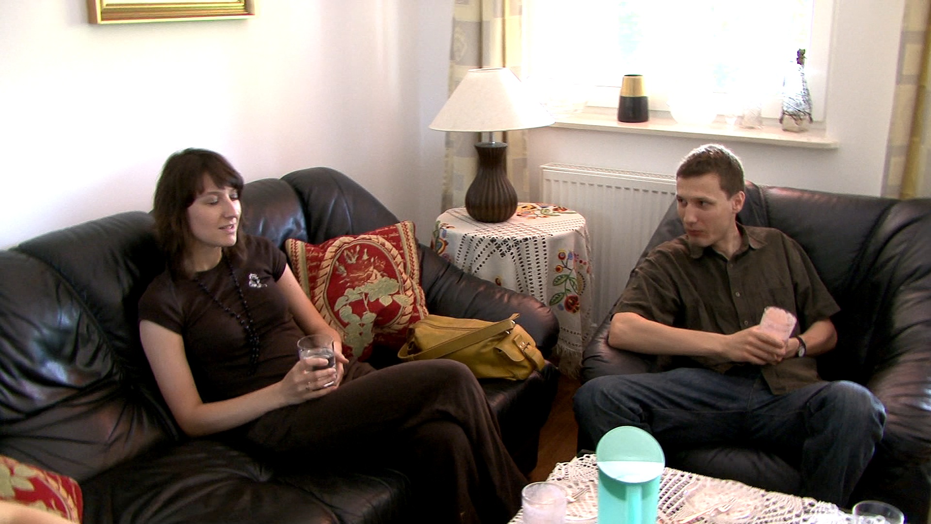

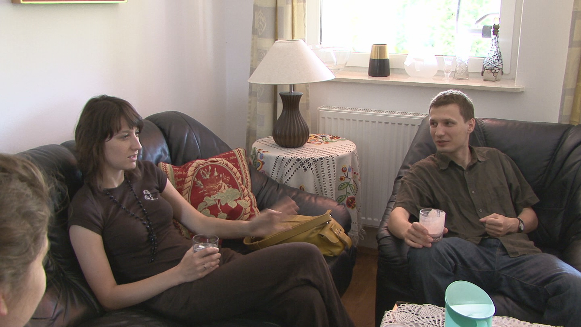

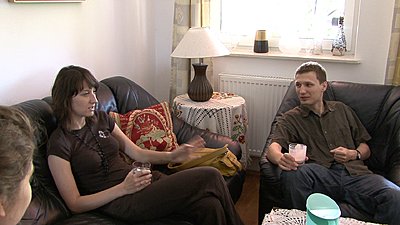

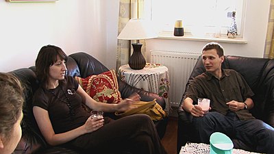

I'm currently trying to figure out how to achieve best overall colours while maintaing details in clipping areas. While I do understand each of the many factors involved on its own (like 8bit versus 32bit processing and the gamma used, studioRGB or computerRGB space adopted, level setting for the highs, video format for rendered output, viewing device calibration etc) - when it comes to educated use of all of them acting together, I'm completely at lost.
Here are 4 grabs, comparing the different trial outputs to the original m2t clip (the picture names are self-explanatory; the "Glenn's curve remapping superwhites to 235 limits" is discussed here:
http://www.sonycreativesoftware.com/...sageID=553488).
One can easily see that the original m2t clip with the 8bit video processing preserves most details in the bright window area...
PAL only please! Rendering 25p projects with proper colour!-oryiginal-m2t-8bit.jpg   PAL only please! Rendering 25p projects with proper colour!-oryginal-m2t-32bit.jpg
PAL only please! Rendering 25p projects with proper colour!-studionrgb-computerrgb-32bit.jpg   PAL only please! Rendering 25p projects with proper colour!-glenn-curve-235-remapping-32bit.jpg

It took me some times to figure out how to see the original image file names... you have to mouse-over the image and let the mouse cursor idle over the image.
Ok, back to the topic at hand...
1- My color curves assume that the video decodes to studio RGB levels. This assumption is wrong for most formats in Vegas 8 / 32-bit (e.g. m2t). To keep things simple I would avoid the 32-bit mode.
