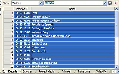

Richard, I've tried this in Vegas 8b and it doesn't seem to work. In Edit Details | Markers, I see two columns: Position; Name. I can select a range in a column using the shift-key, and using this at the beginning & end of a column, I can select the whole column, but I can't select both columms at once, nor can I use Ctrl-A to select everything. Furthermore, once selected, while copy & paste are available, cut is grayed out.
Correction: just found out how to do it. You need to select the range of gray numbers on the the left. That selects both columns and you can then Ctrl-x. See example:
