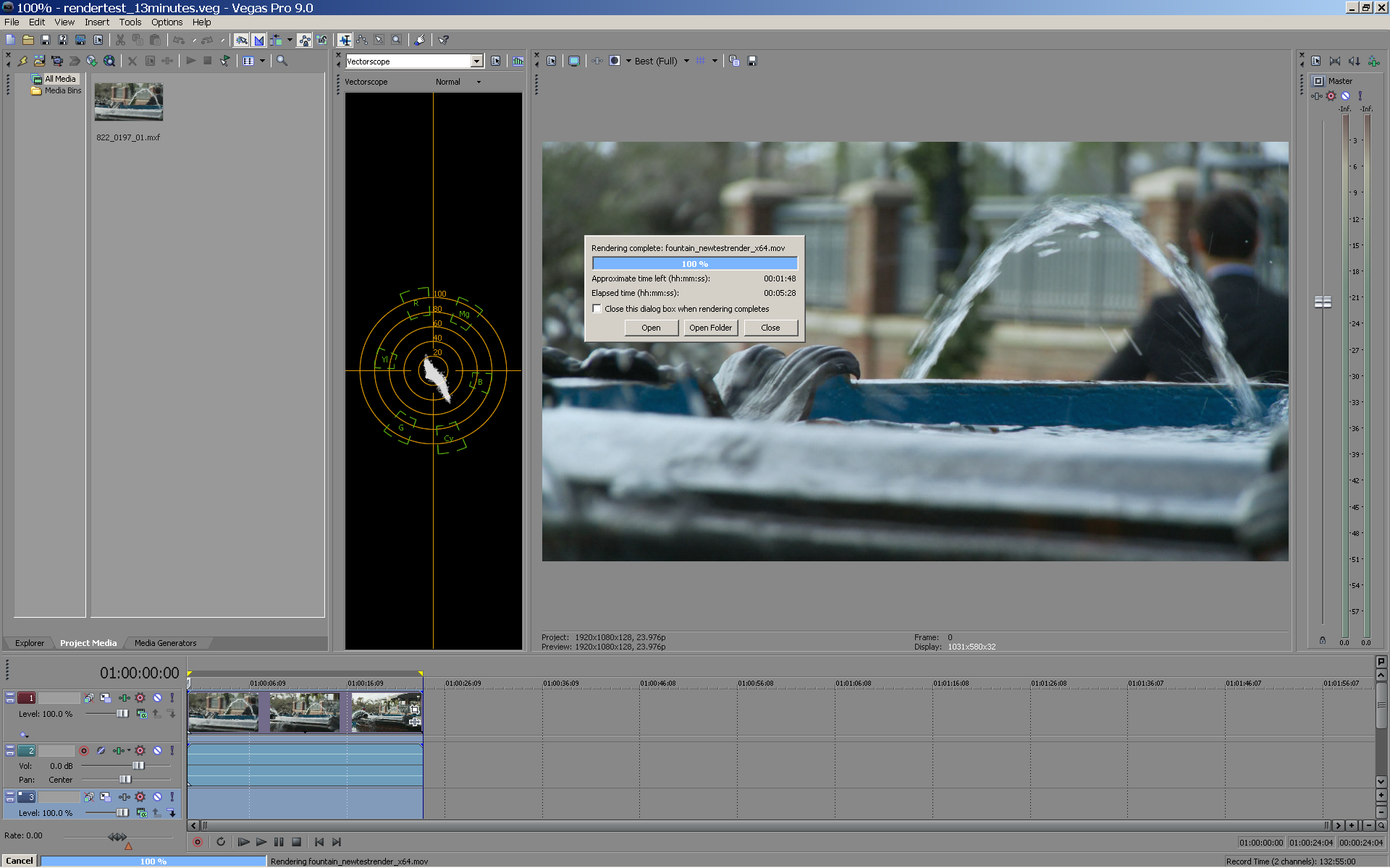

Jeff, I don't know how your system is configured or tuned, but the rendering jump from 32bit to 64bit has been HUGE for me. I did a test render on a old HD file last night in 9.0 32 bit and it took 13 minutes. I saved the .veg file with the ending _13minutes. I then opened that veg file in 64 bit and rendered out. I'll let you see the attached screenshot for results.
This test was on my laptop. I haven't tested in the office yet.

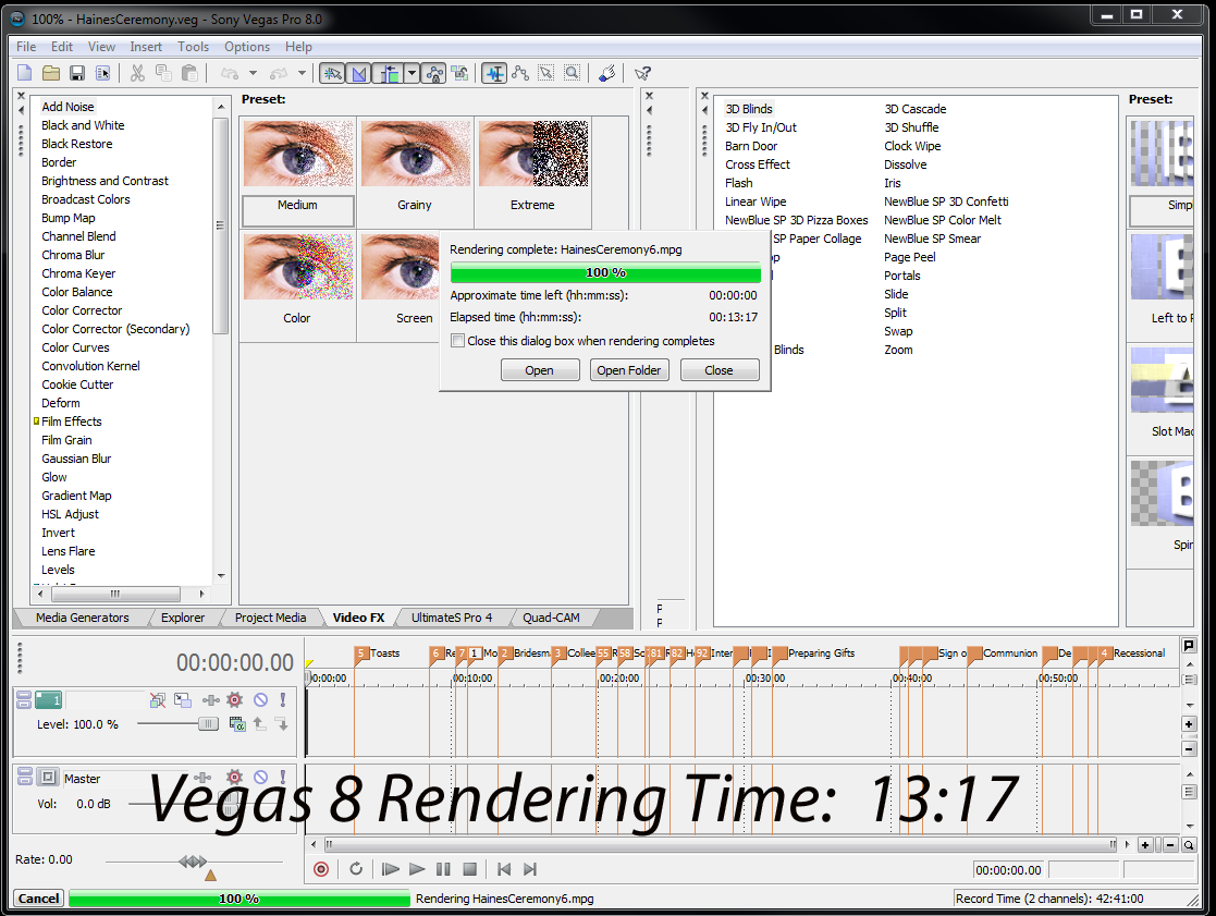

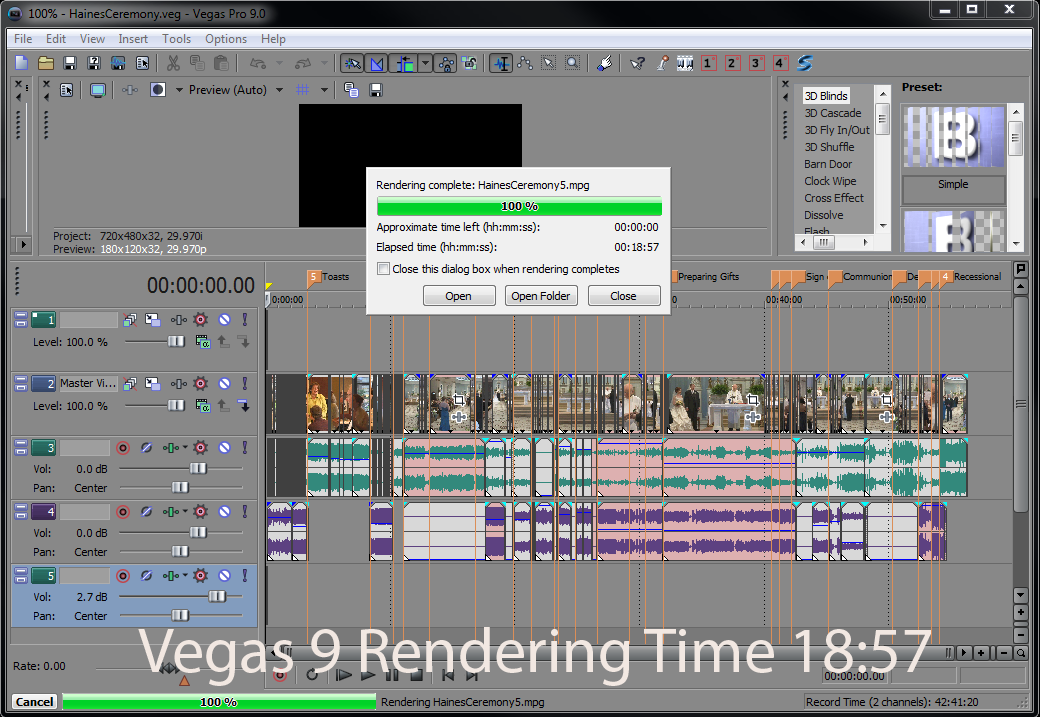

Perrone, don't ask me why, I don't know. I'm not sure how system configuration could cause a 64 bit app to run slower in a native 64 environment, but I suppose it is possible.

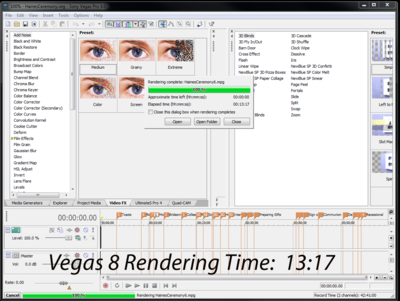

I rendered same project below from same hard drive (Velociraptors in RAID 0) to same location and you can see the results below.
I checked my cpu temps during both renders and they were the same at about 59F during both renders.
Yang, my opinion is formed on very little experience yet, but it seems to me yes the 64 bit version does handle preview better (I've only tested it on one project that has a line of AVCHD in it).
You can't go by what I say but I would cautiously suggest 64 bit version "might" be safe. They have worked out a lot of bugs. The text thing was really scary, but they claimed to have fixed it. When that happened to me it freaked me out.

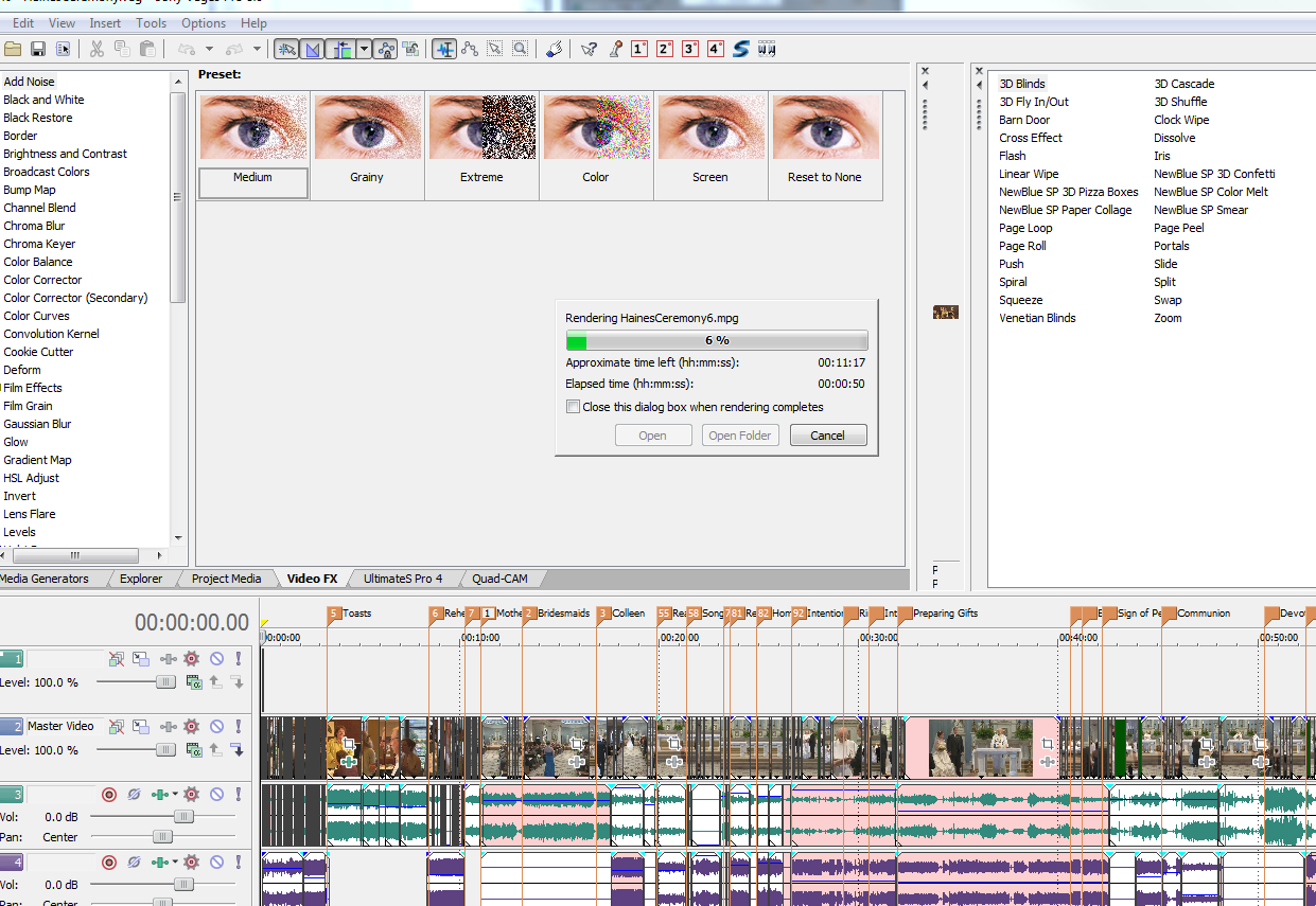

Default settings. 8 bit and good. To even it up I set Vegas 8 at Best and it is on track now to finish same amount of time or so. See below image. I am leaving and don't have time to wait for it. BTW the projects have different numbers in the names, that's just me naming them in the render dialogue box differently, am using same project each time. I'll try it on others later.
