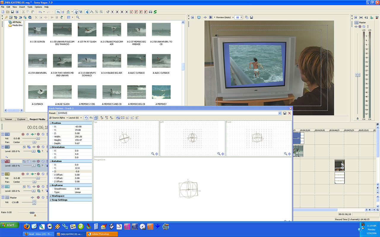

3d Compositing
I'm having a little trouble compositing video over a TV screen. I cant seem to get the aspect ratio right. Anyone have any tips on how to do this? Thanks!

You really have to apply some pincushioning and barrel distortion to get this right. I think After Effects is a better tool for this job but I do not speak from much experience. Then there is the the matter of adding lighting cues.
