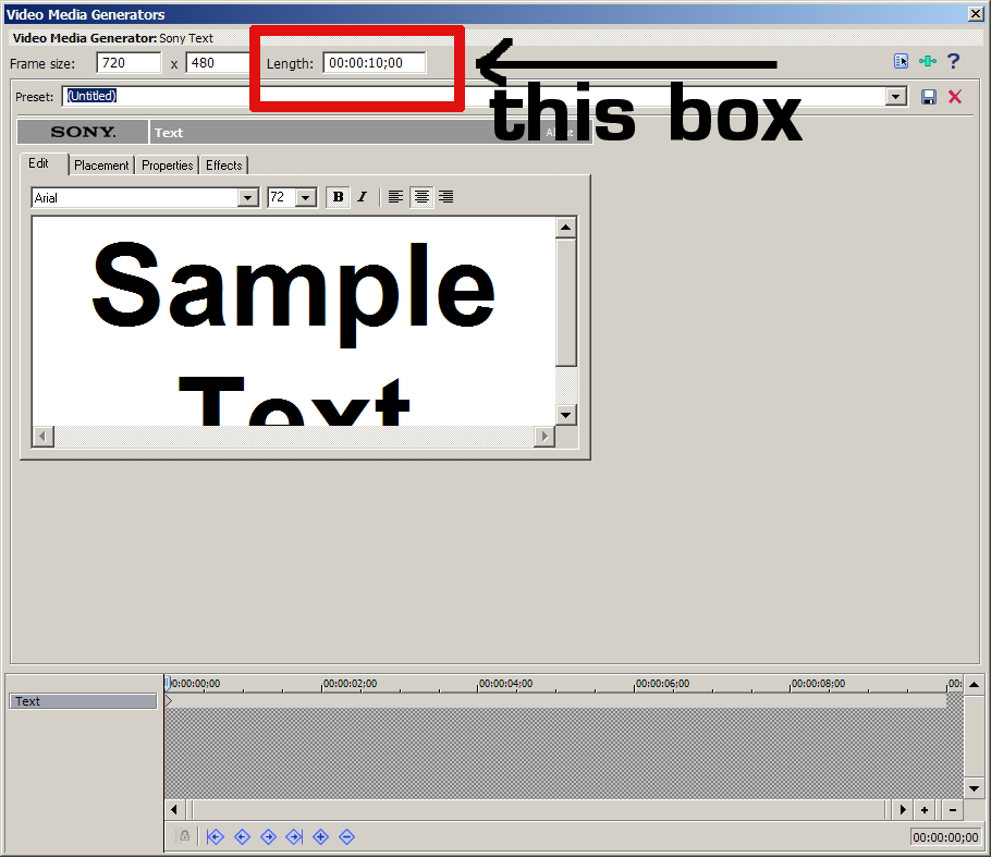

Location: Windsor, ON Canada
Posts: 2,770
Originally Posted by Sam Houchins II View Post
where can i change the "length" in the upper right as Ed refers? Maybe it's a layout difference in 9 vs 8?
Hopefully this picture will help.

Old February 13th, 2010, 01:33 PM   #14
Posts: 2,770
This issue was discussed quite a bit in the Media generator length question thread and the bottom line was that Edward is correct.

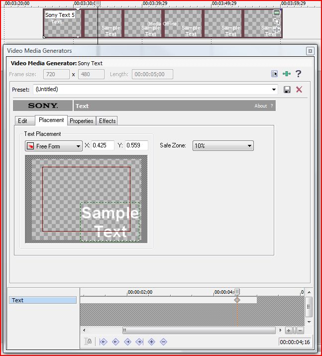

Location: Fredericksburg, VA
Posts: 282
You guys are so awesomely helpful.
One odd bit i noticed trying all the tips, was that following Ed's technique, i was still left with the initial created text media's length at it's base, but was allowed to stretch it after that point to whatever length i wanted without it continuously looping over and over; but the clip's own timeline in its properties box remained at only the original length (in my case 5 secs). An odd observation i thought. In other words it still had the little triangle indicating a "loop," though looped just once.
When i did a couple of keyframes, they only affected the first, original segment.
It looks to me that correcting the time in the clip length box is still needed if going this route?
cool tips. will save me a bunch of steps adjusting title clip lengths now.
