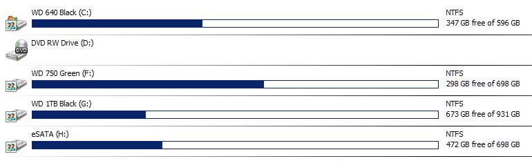

Re: New Computer - Vegas issues - Advice needed
As a Vegas noob I would like to peek in here and ask how you would setup your work flow on a setup of hard drives like mine pictured below.
The C:\ (OS Drive) and H:\ drives are RAID1 setups. The eSATA drives are WD RE3 enterprise drives.
Opinions are like....... well you know, everyone has one.
But here is mine,
Windows on C
Source files on G
Render to F
Thats just a nice easy solution that cant put you to far wrong.
If you were rendering with no recompression the green drive may hold you up a bit, but with any kind of FX on the job it shouldnt be noticeable at all.

Gerald has it spot on. Do as he suggests and you'll be fine.
