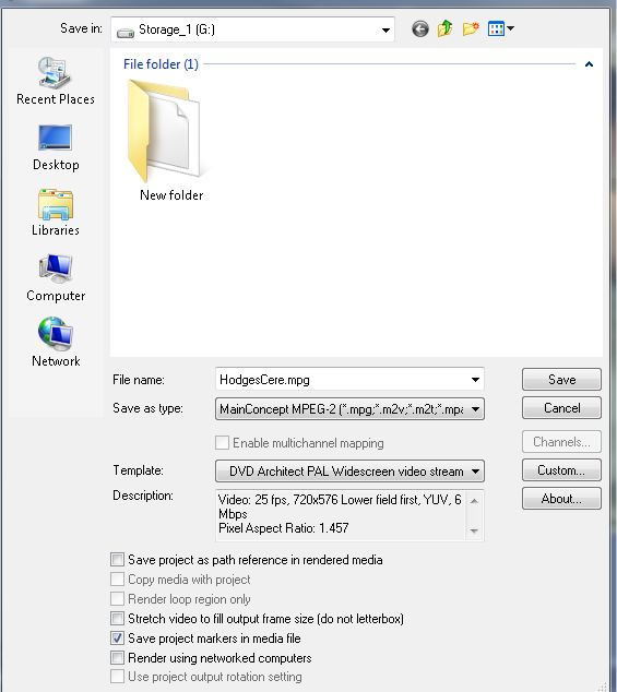

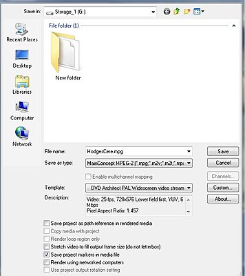

My method was to first batch re-encode the original footage.
Then, you edit the new footage, and render out to the template as shown in the attached pic. BTW, you were using the correct setting as shown in the photo, right?
Choosing the settings in Neoscene is the tricky part, it's not hard, but you will need to feel your way around as I did.

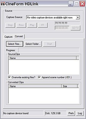

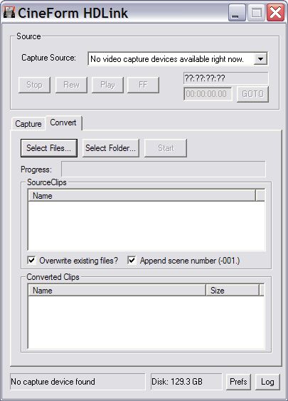

I've run the program and I get a convert/capture window called hdlink.
I've just converted one clip, took forever and am left with a file 700mb which
Vegas won't open, codec error.
What is it supposed to convert to.
Regards
Richard

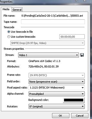

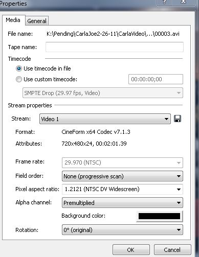

The following must be done for Cineform files to look right. It is complicated why this is so, but just do it.
Bring the Cineform clip onto the Vegas timeline.
2. Open Project properties and match your project properties to the clip and close.
3. Click on Project Media tab and right-click on the clip. Select properties and click. Go to Pixel Aspect prooperties and select the correct setting. For me it is 1.2121 for widescreen DVD, but for you it will be different.
4. Important! go upward to the save icon to the right of Stream as shown in the attached pic. click save. You're done. You will not have to do this again for Cineform files.
edit your files and render to the correct setting for DVD.
