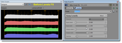

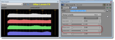

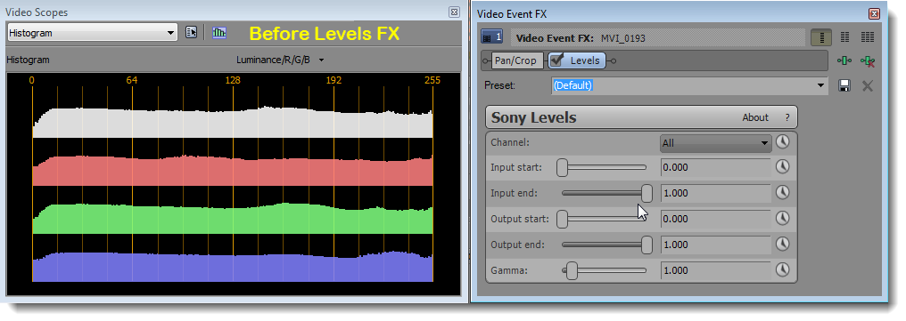

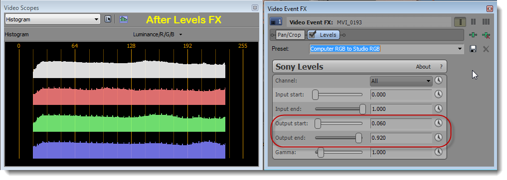

I'm don't know much about Magic Bulllet, but I would suggest you make sure that Sony Levels is the last FX in your FX chain. Then use your Video Scope Histogram to adjust the Levels Output Start & Output End to get Luminance into the 16-235 range.
...Jerry
