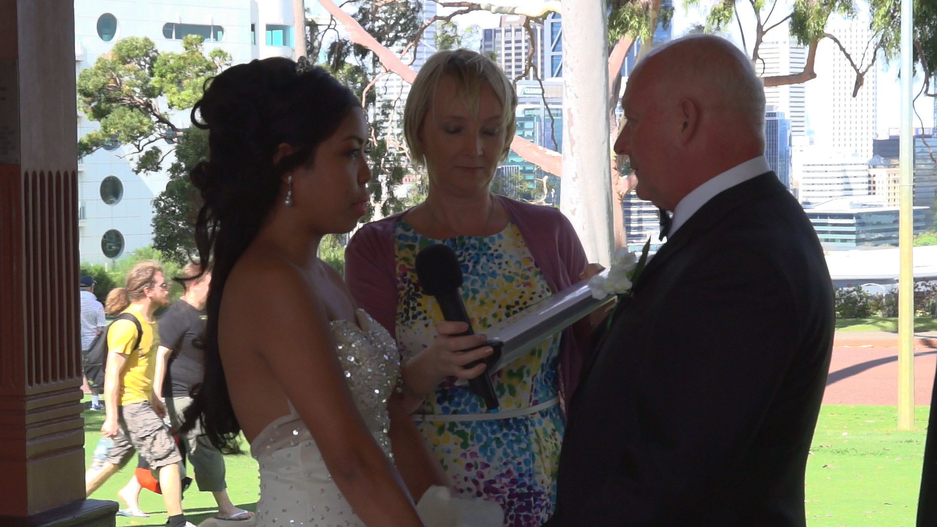

Here is a screen grab to play with ... as you can see the background is fairly blown out already and skins tones have gone crazy. What I normally do is add an Invert plugin followed by the CC and then another invert so I get my footage back to positive again. However I still tend to have to play via the scopes with gamma, gain and offset but never quite know if I should push gamma quite high and then add a little gain and adjust level with the offset or only push gamma a tiny bit and then add a fair amount of gain and correct with offset???
Thanks again guys for all the advice
Chris

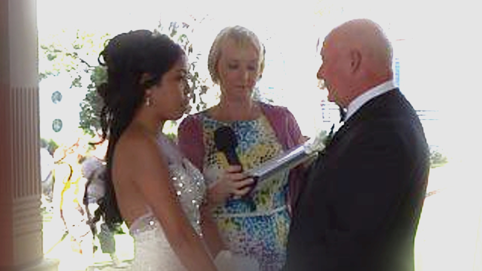

Here's my take on it. The BG isn't doing much for the story anyway. So, I've gone for blowing the BG and concentrated on the foreground using ColorFast+Levels+Bump Map+Soft Contrast. Using a nice white background - some detail, but not the blokes with the rucksacks! - is this:-
