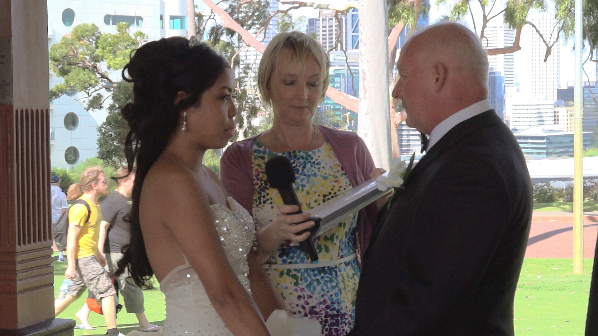

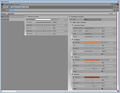

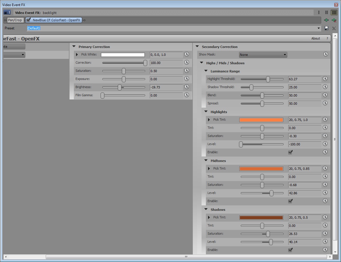

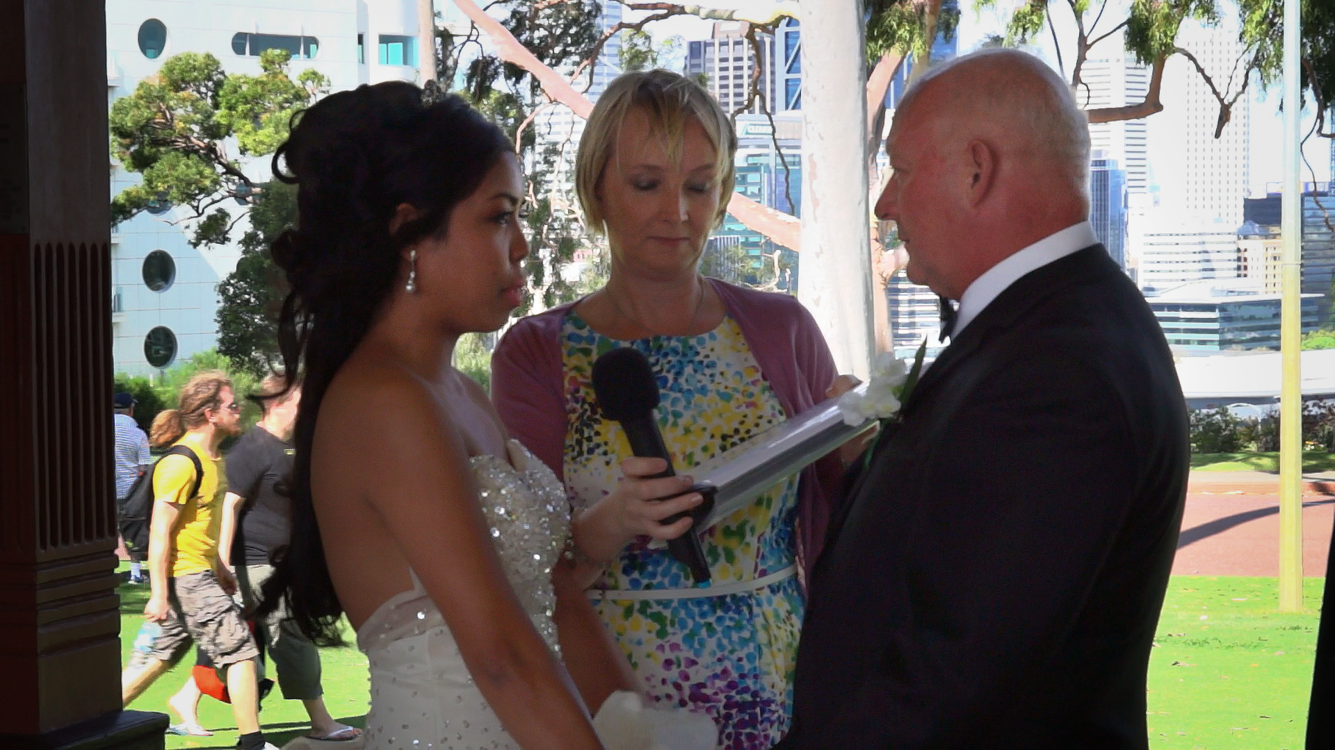

I did this with ColorFast:
Didn't want to "brighten" it too much but you can definitely see the faces now. Of course, you could easily go further and I actually lowered the brightness on the blown out background too.
CC Correct Sequence? Gamma, Gain Offset-backlightcorrected.jpg   CC Correct Sequence? Gamma, Gain Offset-backlightsettings.jpg

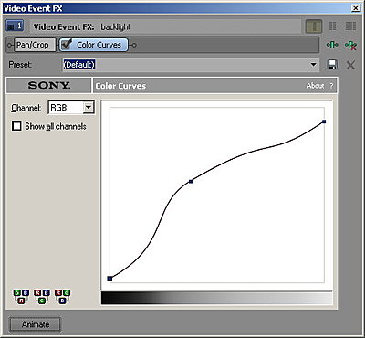

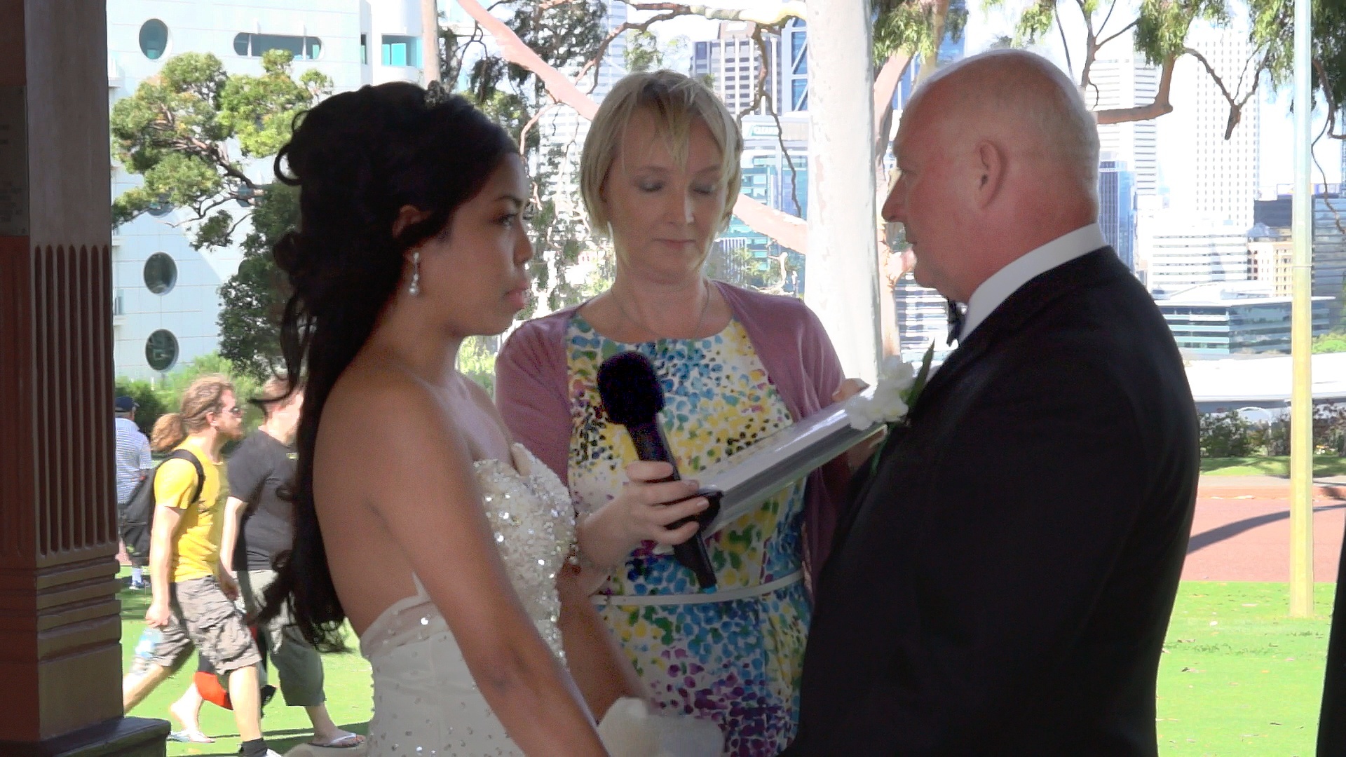

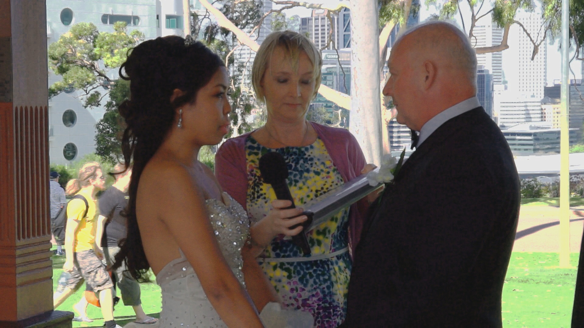

The same with Sony Color curves:
CC Correct Sequence? Gamma, Gain Offset-image1.jpg   CC Correct Sequence? Gamma, Gain Offset-starpliktuve-1.jpg
