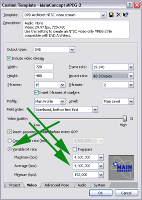

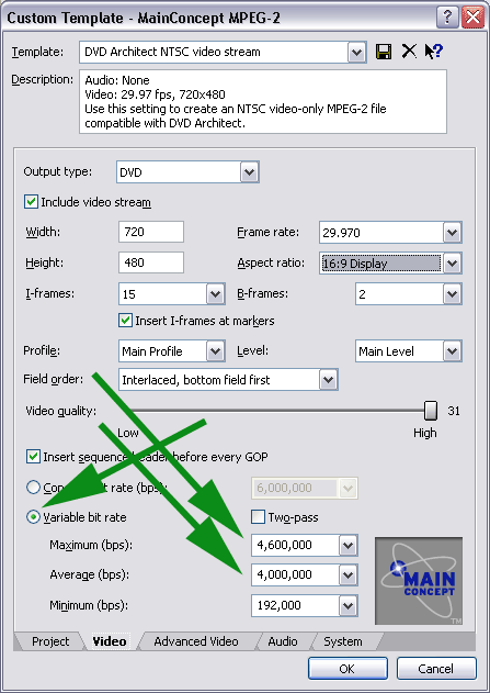

In this image, you can see where you set the values. You don't get a dropdown for a specific number, you have to input your own.
Just looking at the SR 80, it's already MPEG, so not sure where/how you got avi's out of it. You converted them somewhere?
