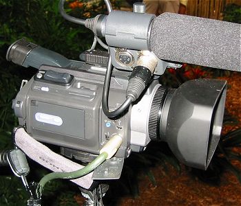

PDX10 kit contentsThe other DV camera I own and have operated extensively is the Sony PC3, with one CCD and a Carl Zeiss lens. I have become quite used to the PC3 and love it in spite of its weird form factor, useless hand grip, lousy stereo mic which points upwards, bad pixels and jaggies. I have briefly used other good quality single and 3 CCD cameras, so I am not easily impressed. And I am impressed... image and audio quality are very good. The camera is easy to operate. Stabilization, automatic exposure and focus all perform well. The main things I do not like about it are battery charging and duration, physical balance and the manual. I experienced some vertical smear on very extreme high contrast and some noise in low light, but these problems can be kept under control with good shooting practices in normal conditions.

photo from NAB 2002I was surprised by the apparent quality of the lens. It's not a Carl Zeiss lens but internal reflections are very low and contrast and clarity are quite good across the whole zoom range.
