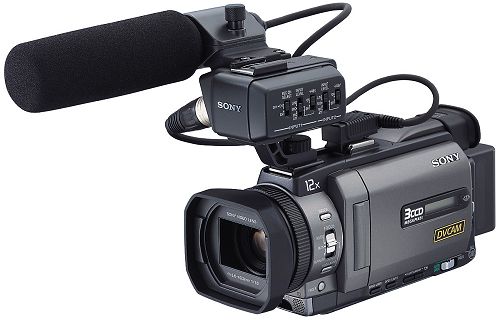

Audio:  A clear winner here. Audio is very clean, much better than on other DV cameras I have experimented with. The built in stereo omni mics performed surprisingly well, with the supplied on-camera directional doing quite well too, although the gain is not very high and it picks up a lot of handling noise if the high pass filter is not used. Of course the latter is to be expected from such a small camera and the mic mount provided by Sony is not of the suspension type. Connecting a wireless mic receiver to the other XLR input proved to be straightforward and the result was very good sounding. To my ears, as good as my portable pro DAT machine.
On my wish list: some more gain and perhaps a better directional mic. It would also be desirable for the camera to record all four channels of DV audio; the built-in omni on one stereo pair, the XLR inputs on the other stereo pair.

Having played around with the PD150, XL1 and also a few shoulder mountable cameras, I can say the PDX10 is not the easiest kind of camera to handle. It does not seem particularly well balanced, is too small to put on your shoulder, is too big to hold comfortably and keep steady with one hand (at least one of mine), and it gets worse when you attach the XLR input module and directional mic and wireless receiver. I guess it will get terribly worse with a wide angle adapter, although a high capacity battery might compensate a bit since it sits on the rear. Considering the kind of cameras film guys usually put up with (not to mention having to run a separate recorder for sound), we are still better of with a badly ergonomic DV camera. Surely this little wonder is lighter and easier to hold and operate than even some DV cameras. The XL1 comes to mind. Still, I remember I could put an old Betamovie or Panasonic VHS camera on my shoulder and get a more stable image. If you want to buy a shoulder mountable DV camera you have to spend much more, it's quite frustrating. I guess it's necessary for the manufacturers to offer some kind of real added value in their pro equipment, because since the DV revolution all the semi-pro stuff has gotten so good!
photo from NAB 2002Enough whining on the ergonomics. There is something I am very happy about: tape and battery can be removed and inserted without having to detach the PDX10 from a tripod mount. This may sound trivial, buy it really is not when you use something like a GlideCam. In the case of the PC3, every time I ran down the battery, I had to take the camera body off the GlideCam, change the battery, put it back on and recalibrate the whole thing, which is quite a pain.
