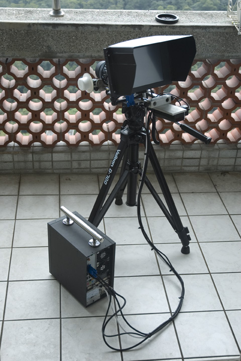

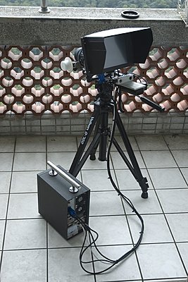

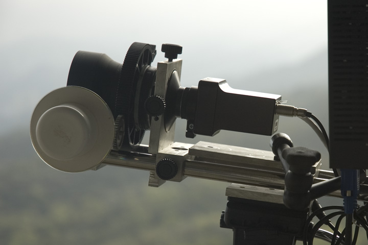

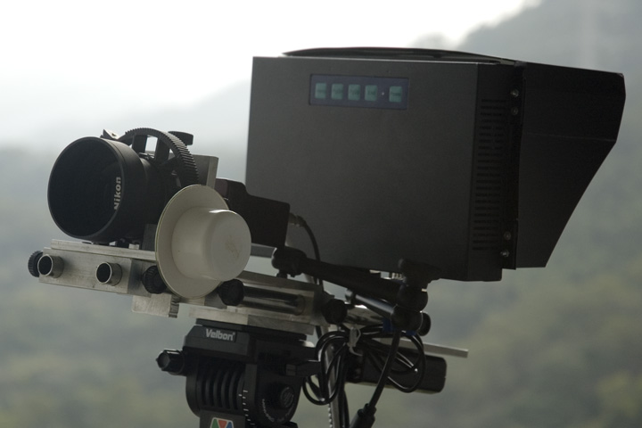

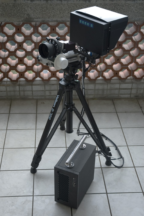

Hello guys,
I have built a portable PC for recording. It runs on a 12V7AH lead-acid battery inside the case, and can take external DC power source. The main specs are as following:
CPU : Pentium M Dothan 1.6G
RAM: DDR2 667 2G
HDD: Seagate 2.5" 120G x 2
monitor : 8.4" touch-screen LCD
The battery runs only about 1 hour. The HDDs can store 50 minutes of uncompressed files. I'm thinking adding a removable interface for the HDDs so I can quickly exchange them when they are full.
The original idea was to attach the whole thing together, but that would be way too heavy for my small tripod.
Sumix 2/3" 1920x1080 CMOS-dsc_4866.jpg   Sumix 2/3" 1920x1080 CMOS-dsc_4867.jpg
Sumix 2/3" 1920x1080 CMOS-dsc_4876.jpg   Sumix 2/3" 1920x1080 CMOS-dsc_4873.jpg
Eric Wu is offline   Reply With Quote

Focus wheel and roller
Hi Eric. What solution did you use for the focus wheel ?
I noticed the portable PC holder is a towel holder - nice touch.
Is the lens and camera support also DIY ?
Looks quite nice actually..

Thank you guys,
The lens in the pictures above was a Nikon 50mm F1.8, with an F-mount to C-mount adapter. The rod support and follow focus was from my old DIY projects, originally for my DIY 35mm adapter. The model of lead-acid battery I use is for small UPS and I bought it from a local electronics store.
I have some other footages but they were all early tests. I'll take the camera outside and shoot some more this weekend, now that my portable recorder is ready. More samples are coming.
