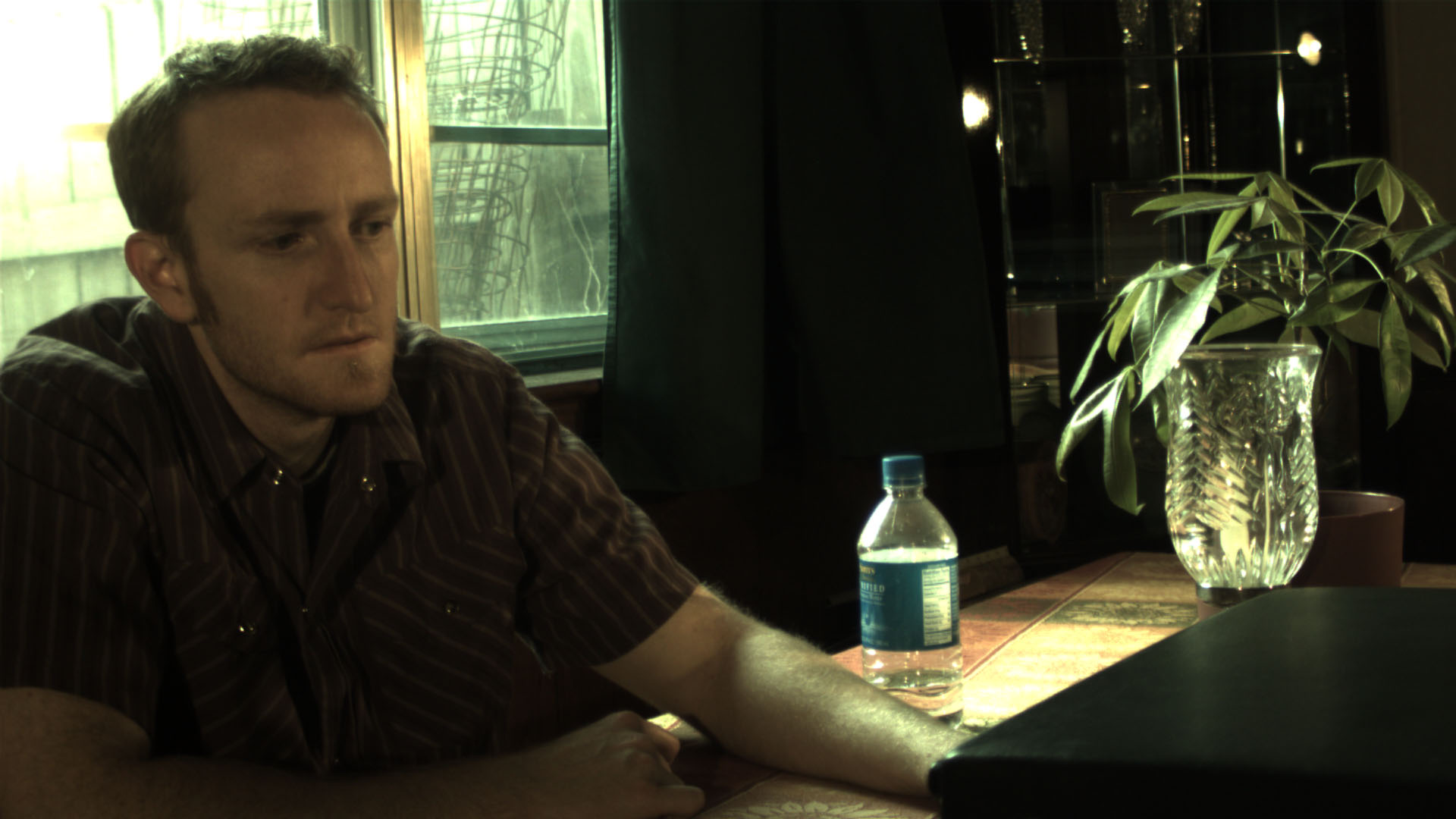

I took my 12A2C camera to a film shoot last week and shot some on free time in between setups. Got some dolly shots a little hand held and tripod.
I'm not happy with the way it video turned out. Looks very soft to me, even after careful focusing. I blame the TV zoom lens I was using wide open.
I just bought 2 Carl Zeiss lenses, should have them in within a week or two. Hopefully they will be sharp enough to render a great image.
The attached picture was not white balanced. Did not have time.
Sumix 2/3" 1920x1080 CMOS-frame_82.jpg
Daniel Lipats is offline   Reply With Quote
What did you use to debayer?
In camera debayering? That may be another source of softness.

Old April 20th, 2008, 03:57 PM   #352
Location: Sevilla (Spain)
Posts: 439
Did you use laplacian to debayer? The other filters are quite soft.
Jose A. Garcia is offline   Reply With Quote
Old April 20th, 2008, 04:25 PM   #353
Posts: 260
It would have been the default "Bilinear" setting.
Old April 20th, 2008, 04:45 PM   #354
Posts: 439
Then I think your lens combined with the bilinear filtering softened the image.

Old April 20th, 2008, 09:33 PM   #357
Posts: 260
I just shot a Bilinear vs Laplacian test. You are right, laplacian is much sharper.
But with laplacian enabled, FPS falls to a maximum of ~11.
Old April 21st, 2008, 04:01 AM   #358
Posts: 439
But that's just the preview. The same happens with my camera. When recording it's actually at 43fps.
You don't have to search so much for good machine vision primes. Some of the best and sharpest out there are the 5mp certified 2/3" Fujinon primes. They're also quite cheap (about $300 each). If you're looking for tack sharp images, go for them.

Old April 21st, 2008, 07:54 AM   #359
Join Date: Mar 2005
Location: canterbury
Posts: 411
I'd add another vote for the fujinons. I would also like to see the schneider ones (cinegon and xenon). They're expensive which may mean they're higher quality (of course that's not always true).
Daniel, how do you gauge exposure when you are out shooting? The image has a lot of blown out areas. I found when playing with sensor heads that getting a good exposure is very difficult especially if you're not previewing via a LUT.
What's the level information like in the original frame?
What's the status on getting RAW frames out of the camera? You should only need simple debayering for preview and deal with the main processing later on (where you can choose different solutions for different types of images).
