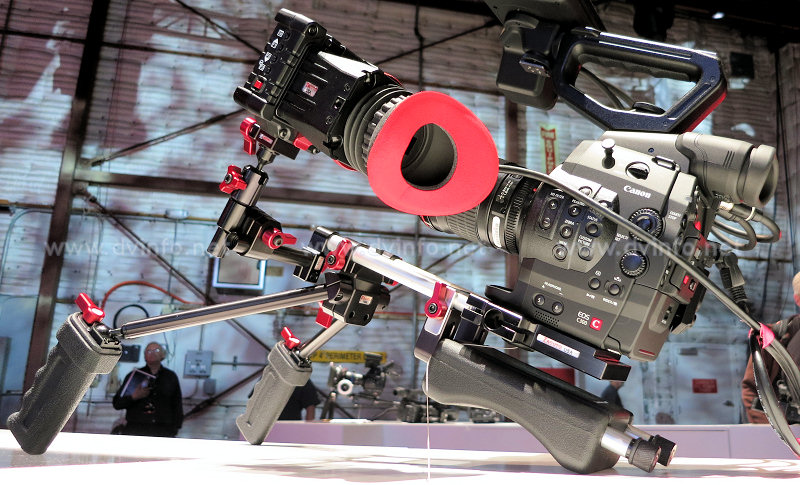

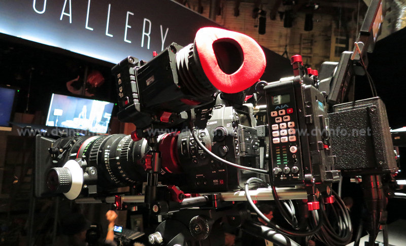

Old November 7th, 2011, 02:52 PM   #224
Posts: 27,382
Re: C300 Discussion
Originally Posted by Mike Marriage View Post
Therefore shoulder mounting more or less dictates buying an additional VF.
Well, that's a given... see pics below (click to embiggen).
On the Zacuto shoulder support rig, they should have left
the top handle off... not sure why it's on there.
This adds to costs and will never be as convenient as a dedicated design.
They're placing a greater emphasis on modularity and compactness.
At this level -- $16k to $20k or whatever it is, the cost of a third-party
EVF component like this Zacuto piece is insignificant. Budgets for the
camera dept. should *always* include a good degree of latitude to cover
extra gear like this... nothing new here.
Old November 7th, 2011, 03:33 PM   #225
Location: NE of London, England
Posts: 788
Re: C300 Discussion
But Chris, if it was properly modular why is there no VF port (or at least 2nd HDSDI output)? I don't think HDMI is suitable for pro work and know many who would agree.
At this price I would expect a proper VF solution designed as an integral part of the camera. I would not expect to have to daisy chain HDSDI cables or worse still HDMI cables into a 3rd party solution. I really don't think I'm being unreasonable here - I spend a lot of my time with my eye against a VF and it is absolutely critical to achieving decent footage. You are arguing that it should be taken as "a given" that a camera needs two VFs?
Eh? Apart from the equally badly designed F3, name me a recent professional level camera that isn't designed to provide a viewfinder positioned to shoot from the shoulder? (Obviously within a acceptable weight limit).
Your argument that the camera is so expensive that the extra cost is irrelevant appears totally backward to me. Sure, on a cheap DSLR where video is an ancillary function I expect compromise. On a professional cinema camera I expect the design of essentials like the viewfinder to be integral and not rely on 3rd party bolt-ons.
The issue is that the design clearly stems from an SLR form factor not a film/video camera form factor. I see no ergonomic reason for this however I can see HOW it happened - the R&D was led "by a member of Canon USA’s still photography EOS team."
In my opinion that was an error and has led to a number of design flaws.
