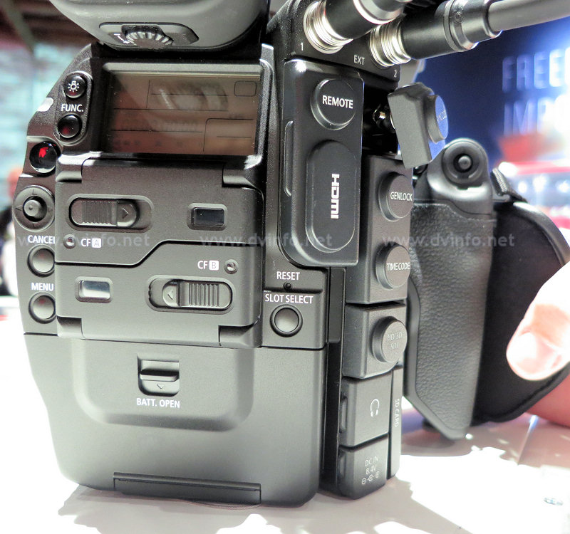

Actually there *is* a VF port, it is one of the jacks where the monitor / XLR unit plugs in.
See attached pic (click to enlarge). The two jacks at the very top right -- labeled "1 EXT 2"
-- one carries the viewfinder output, the other is the two-channel XLR audio input. Is it a
proprietary connection? I don't know, it probably is. It's definitely an HD output, and it's
definitely not HD-SDI nor is it HDMI. Unfortunately I neglected to get a photo of it, which
was an oversight on my part. I'll try to find out.

Erik Allin from Canon said the EXT 1 and EXT 2 connectors are proprietary, but they plan to release the specifications to accessory manufacturers. So I think it won't be long for someone to come up with something like Abel did to adapt a broadcast VF to the C300. In fact, the mounting will probably be a lot easier. This is coming close to my dream of this Ikegami camera: http://www.dvinfo.net/forum/digital-...ml#post1513023

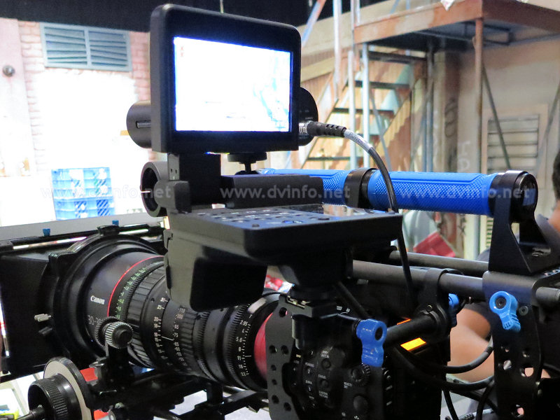

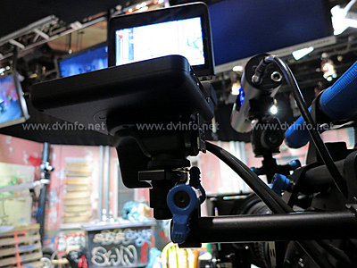

Actually, the LCD / XLR unit included with the C300 can be positioned
on the left side, or wherever you want to put it... see pics below for an
example of a left-side mount, using an arm from RedRock Micro.
