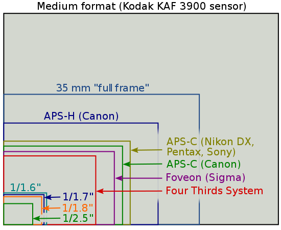

3. Does anybody know what the equivilant CCD would be for this camera, for example my Canon XH A1s has 3 1/3 inch CCD's, what would the 7D be equal to?
The size of the sensor:
It's about 10x the size of your A1.
I've attached a chart. Your sensor is slightly smaller than the smallest example shown. The 7D is a Canon APS-C.

Got some 7D questions (some confusion)-550px-sensor_sizes_overlaid_inside.svg.png
