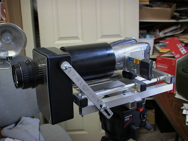

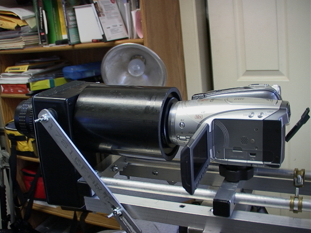

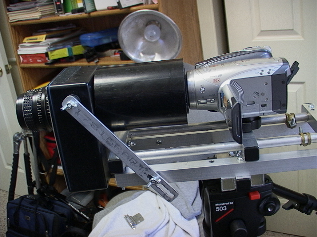

35mm Adapter testing
So I've been trying to tune my DIY 35m adapter, and rigged a way to attach the HV20. Mind you, this thing is a bit unpredictable, and I have a Letus coming, but I have been able to get some images with this set up. The adapter is a rough approximation of the Micro 35 do it yourself project, that you can order plans from from Redrock.
At this point, it appears that an achromat is in order. I am using one I bought from Cinevate. Would love to actully try their adapter, but, well you know I spent my money on a camera instead. Here are picture of what I rigged up. An upload of some clips is pending and I will post.
Sony User Tries Canon  HV20-dsc00077.jpg   Sony User Tries Canon  HV20-dsc00078.jpg
Chris J. Barcellos

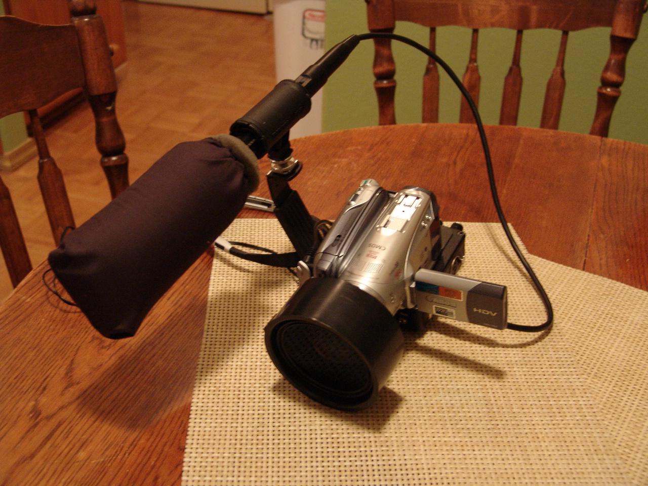

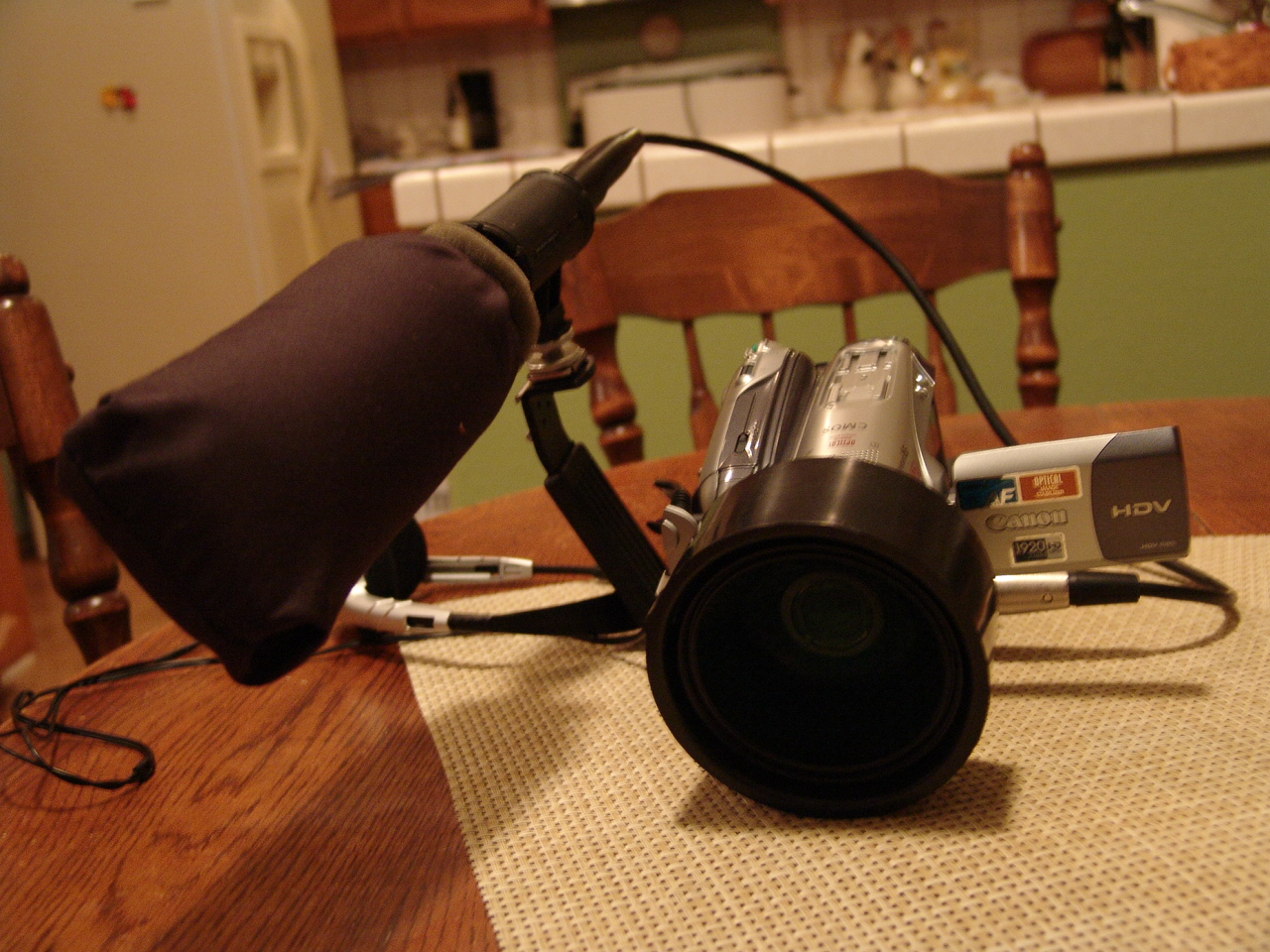

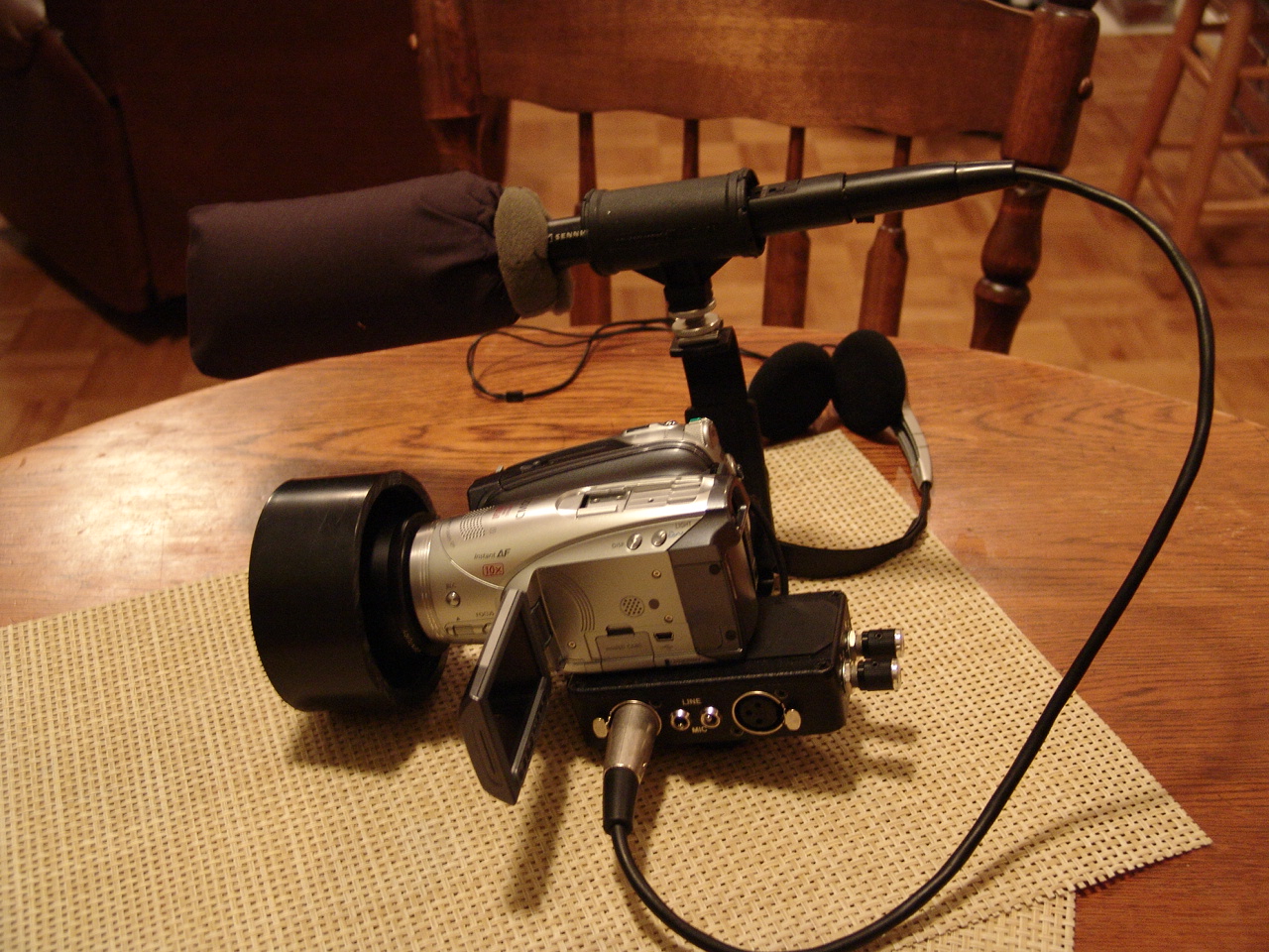

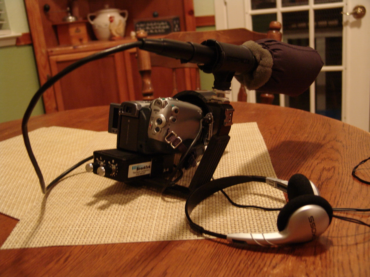

Camera tricked out with Wide Angle Adapter, and ME66 Mic
In another thread, the question of microphone on the camera came up. Tonight I dressed out my HV20 with Beachtek DXA-3 adpater, and mounted my Sennheiser ME66 with K6 power module on a digital slr flash bar I had. To complete the set up, in mounted my Kenko 58mm thread .65x wide angle adapter on the front. Pictures provided below.
Need Wide angle adapter ? I think so. With the bit of experience I've had with wedding shooting, I think a wide would be essential, especially in the dressing rooms scenes, and interior car scenes. I travel by car today to Easter dinner with grand kids in car, and shot them during the trip, with the wide on and wide off. Pretty tight without the wide adapter. See last two photos in group below.
I think a wide adapter should be part of your budget.
Sony User Tries Canon  HV20-dsc06563.jpg   Sony User Tries Canon  HV20-dsc06564.jpg
Sony User Tries Canon  HV20-dsc06566.jpg   Sony User Tries Canon  HV20-dsc06567.jpg
Sony User Tries Canon  HV20-backseatnowideadapter.tif   Sony User Tries Canon  HV20-backseatwithwideadapter.tif
Chris J. Barcellos
