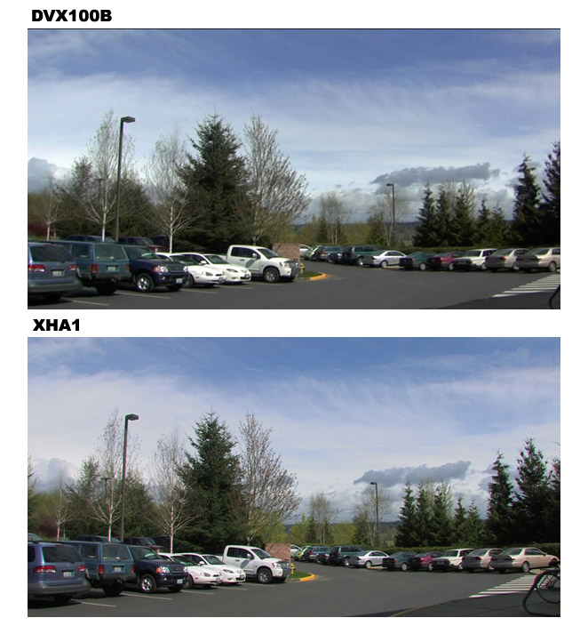

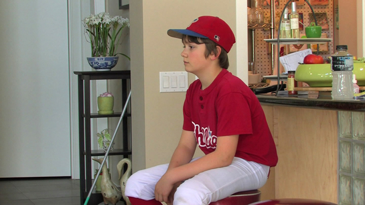

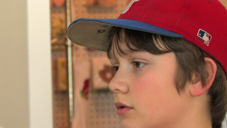

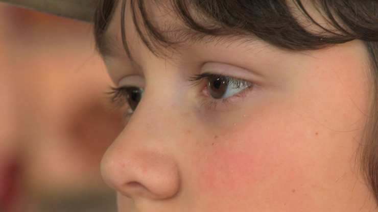

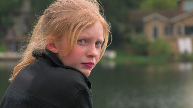

See below for four example shots of my kids on an overcast day and indoors with natural light to demonstrate how the preset handles intense red and skin tones.

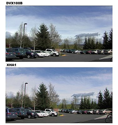

The bottom two stills are a comparison of the DVX100B (with settings listed below) and the XHA1 (with the VIVIDRGB settings).
Here are the DVX settings for anyone interested. Everything is zero in the DVX settings except for the following:
Chroma Level: 4
Master Ped: -5
Gamma: Cinelike
Knee: Auto
Matrix: Normal
V Detail Frequency: Thin
For the bottom two stills, the XHA1 had the 1/32 ND engaged at F3.7 and the DVX had the ND 1/64 engaged at F4.8

So this preset looks pretty darn close to the DVX which I thought was the goal of the Panalook preset. Should this be called Panalook? How about a three way shot of Panalook/VividRGB and the DVX.
It looks like the DVX is crushing the blacks more than the A1. It favors the Canon to my eye. It seems the Canon could be getting a larger lattitude. It also appears that the blue in the sky and greens in the trees are darker on the DVX despite the fact that the white vehicles look closer to blown out on the DVX. This points to more contrast on the DVX (or less lattitude.) I like the fact that the Canon is resolving more shadow detail and higlight detail to my eye. I do large-fomat printing for a living so color comparisons are always interesting to me...
Has anyone shot video of a grayscale to determine if the Canon can capture a higher white to black lattitude. I already sold my DVX so I'm no good for comparisons.

It's looking good (and pretty close to the DVX). There's definately a touch more red in the A1 image - look at the clouds in the lower portion of the sky to the left of the lampost. I shot some footage with the previous settings and noticed that it added a touch of red to skintones - which wasn't a bad thing for pasty Caucasian skin (adds a nice glow), but I didn't have anyone with olive, brown or black skin to test it out on.
