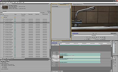

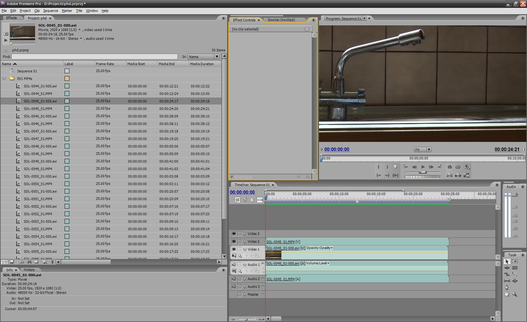

Clip length changes in HD Link
I've only just noticed that converting EX1 MP4s to Cineform AVIs in HD Link is producing clips that are about 3 frames shorter than the original MP4s.
Is this happening to anyone else?
I've attached a screenshot from within CS3 to show the difference between each of the MP4s and their equivalent AVIs.
In every case, the duration is less for the AVIs than for the MP4s.
I am wondering:
a) Why?
b) How? As in, is it simply removing three frames from the beginning or end or are they missing from the middle somewhere or are some of them blended?
I have also noticed that in the tab that lists all this information, the Media End and Media Duration figure should be identical, since all the timecodes start at 0:00:00, but they are also different from each other in every case, whether it's AVI or MP4. How can that be?
John Hewat
Mammoth Media Productions
John Hewat is offline   Reply With Quote
Old February 2nd, 2008, 11:28 PM   #147
CTO, CineForm Inc.
Join Date: Jul 2003
Posts: 8,095
We transcode all the frames that are decoded from the MPEG Decoder we use. If any frames aren't converted they would on the end, possibly from an incomplete GOP. Media End and Media Duration are not suppose to be the same as Media End is an inclusive frame (not an out time in the EDL sense: Duration = End - Start + 1.) It is Premiere that reports this, not CineForm as personal refer an exclusive out time.
