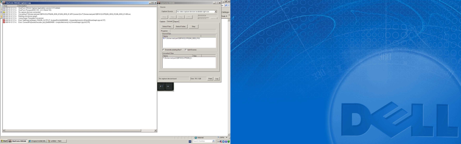

HDlink, error messages when converting EX1 files
Hi David,
Need your urgent help.
HDlink would not convert my EX1 files.
Attached is a screen shot of the log file.
Software used-Prospect HD, latest version.
Johnnie
Johnnie Behiri is offline   Reply With Quote
Old January 21st, 2008, 06:22 PM   #135
CTO, CineForm Inc.
Join Date: Jul 2003
Posts: 8,095
Only need to log window, you scaled the whole screen to the point I can't read the log window. To capture just log, select the window, and press ALT+PrintScreen, then paste the image in IrfanView or any other imaging tool.
Likely you don;t have something install. Recapture the log window and send it to support -- trouble tickets go to www.cineform.com/support
