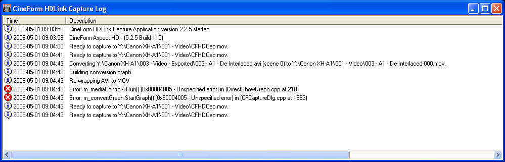

Cineform HDLink re-wrap error
Hi,
Hoping that someone can help me with this ... got my brand new XH-A1 yesterday, downloaded the trial of AspectHD (5.2.5.110a) and I can capture and edit successfully in PPro2.0 using the appropriate Cineform preset.
But ....

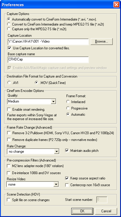

When I try to re-wrap a Cineform AVI to a MOV I receive the attached error (see jpg of log file).
I've also attached the prefs window in case that is helpful.
The error occurs with any Cineform AVI whether it's the original file I captured using PPro 2.0 or the file I export from Premiere after I've finished editing.
I'm just wanting to export a Cineform AVI from Premiere, re-wrap it as an MOV so I can use Sorenson Squeeze 4.5 to convert it to other formats.
Matthew.
HDLink -- various questions-hdlink_log.jpg   HDLink -- various questions-hdlink_prefs.jpg
Matthew Ebenezer is offline   Reply With Quote

Two things.
1) Sorenson Squeeze 5.0 is now AVI compatible.
2) You need Quicktime installed to rewrap an AVI to MOV.

That error is what happens when the MOV MUX can't find a suitable version of QuickTime installed. What version is installed?

Haven't tried 7.4.5, but 7.3.1 and 7.4 work.
