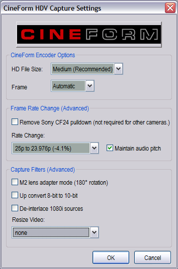

Shot footage in 50i Cineframe 25 and like to edit in the CineForm preset in PPro 2.0 24p.
Clip does not play correctly in the the timeline, but goes directly to the end of the clip.
Brian Panelo is offline   Reply With Quote
Old November 13th, 2006, 01:24 PM   #82
CTO, CineForm Inc.
Join Date: Jul 2003
Posts: 8,095
Within the capture settings panel set "Rate Change" to convert your 25p/50i to 24p or (more common) 23.976p. If playback issues presist after make this change, please file a trouble ticket at www.cineform.com/support.
