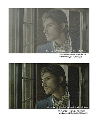

DPX export problem with Prospect 2K
There seems to be a trouble with the cineon exporter filter and Prospect 2K.
I was trying to export some DPX sequences but somehow when loading them in Scratch they were not LOG, I rendered again and same problem. When I open the shot in Photoshop It was linear too.
I did another export from my Laptop, in wich I only have NEO player installed, Same sequence, Same export and render parameters. And that render looks right.

Where you running one in 16-bit and the offer in 32-float AE mode. The importer in NEO Player and Prospect 2K are identical, so the must other operation difference.

Both was in 32 bits, Maybe I had a colorspace applied in one of the compositions, disabling colormanagement did the trick.

I supose AE is confused when your are exporting to cineon and at the same time you have a colorspace applied to the project. And somehow it renders giving preference to the colorspace and not to the cineon exporter values.
Does it sound logical or is another thing?

Your theory is good. The ways of AE sometimes surprise us also.

Hey Sergio, what that looks like to me, is I've seen "linear" from the camera, and your "linear" image doesn't look like a truly photometrically linear image from the camera. Instead what I think is happening is that you're exporting LOG, but the color management in AE is then taking your LOG image and converting it to some type of "print" gamma correction, since that's what the final image resembles . . . it's too bright, especially in the midtones, to be photometrically linear. A photometrically linear (which is a true "linear" image where doubling the pixel value is equal to double the real-world brightness) representation would look VERY dark, in that you would have hard time making out your subject's face, and only the windows would be visible, and most likely hard-clipped (i.e., no knee). I could be wrong, but this is my observation from seeing LOTS of relinearized images from the camera.
Since there seems to be a "knee" to the highlights in that image, and it's only the shadows that are a lot darker (the face is darker too, but the midtones in a photometrically linear image would be much darker than that), it looks to me that whatever was the project working space is re-gamma-correcting the output from LOG to something gamma corrected, like a darker print gamma correction or something of that nature.
