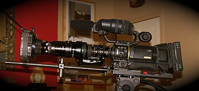

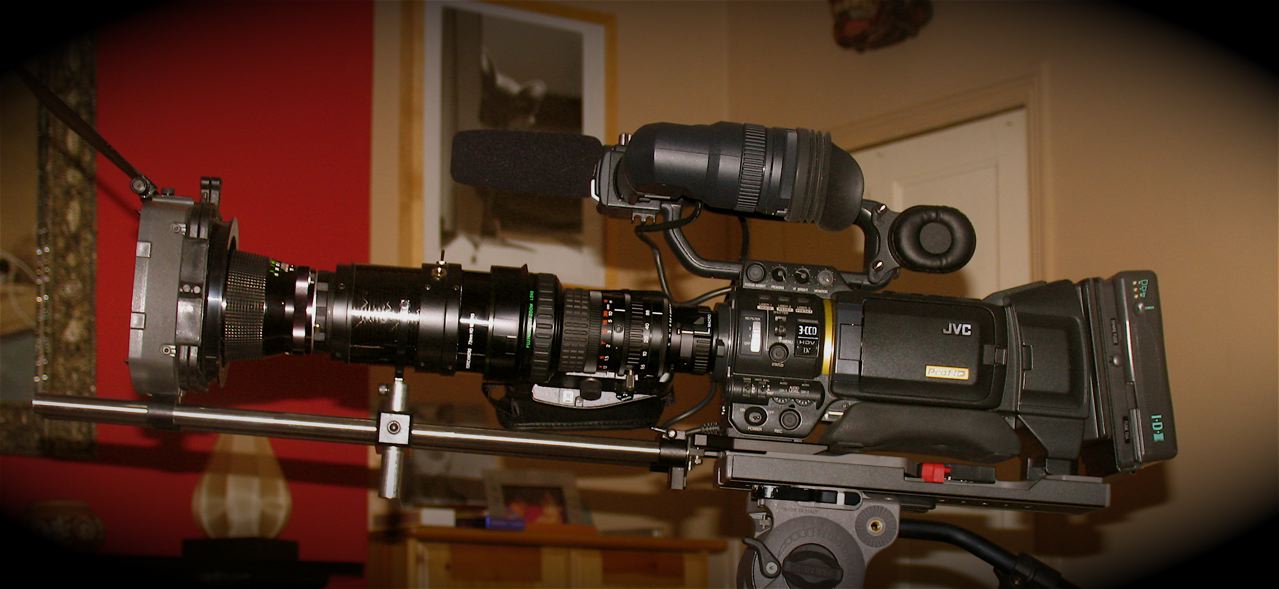

Here is a new pic of the JVC with the Brevis. I will set it up with the M2 soon.
