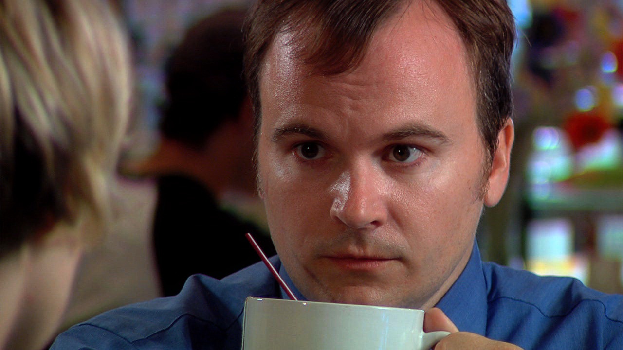

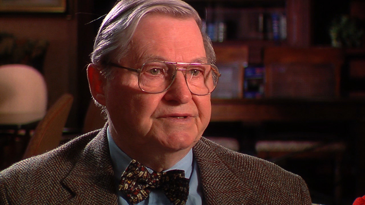

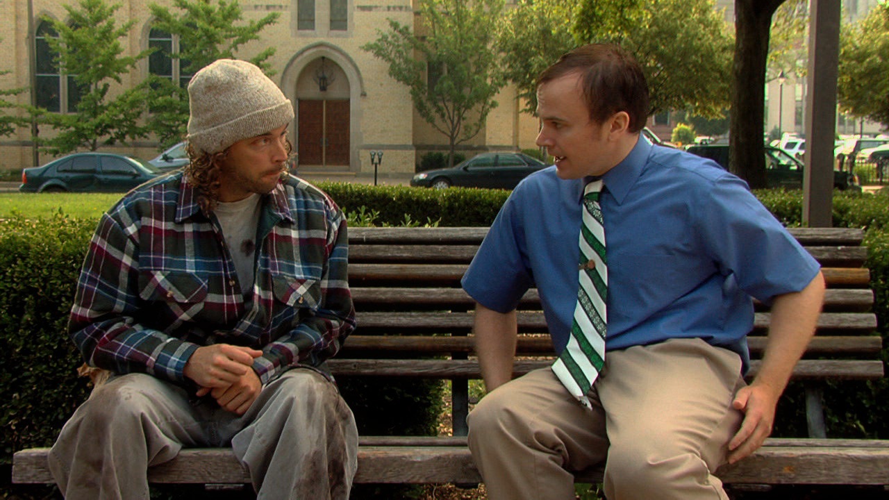

Originally Posted by Craig Parkes
I'm just trying to gauge now whether what you are describing is a genuine massive flaw for the camera for it's intended purposes, or if it's just proving to suffer more noise than expected in certain environments.
Definitely the later - suffers under certain circumstances. Like I said that was the worst I've experienced (and on one of my first shoots too). The best thing you can do is calibrate the camera and test test test. I haven't found any noise unacceptable since then. When using the stock lens especially there are boundaries of acceptable sharpness and color qualities (the subtler of which I'm still figuring out). It can be VERY sharp if your lens is finely tuned.
Here are a few good grabs to help encourage you. It's a great camera and I would guess a killer combo with the Mini35!
(BTW, the "HollandHome" grab does exhibit some CA on the glasses and hair. Shouldn't be a problem if you use something other than the stock lens. The average person doesn't notice anyway.)
JVC HD 201 and 35mm adaptors-luckyday-brettcu.jpg   JVC HD 201 and 35mm adaptors-luckyday-park2shot.jpg

I think it's partly a settings issue and partly situational. I still get some noise every now and then but it seems to be mainly on darker, predominantly red scenes. It hasn't been enough of an issue for me to want to troubleshoot so maybe I've found the right matrix settings.
I love the camera, but I think I'd still opt for the RED if I could, Joel. ;-)
