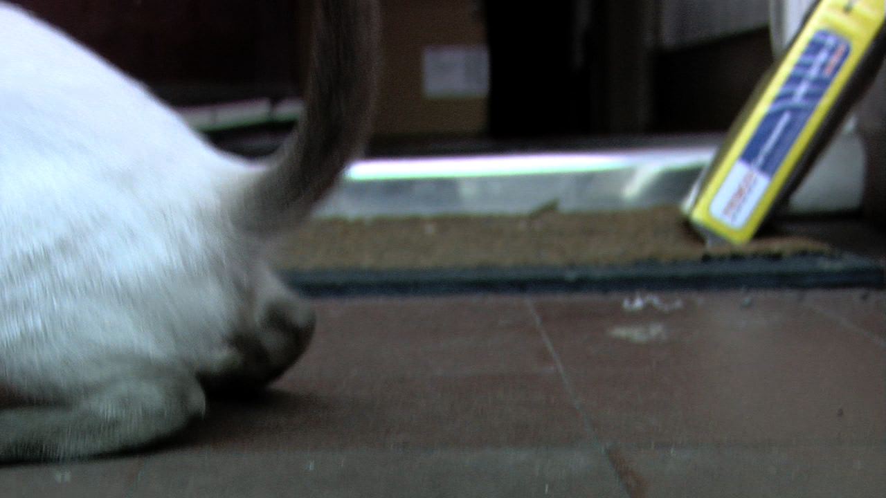

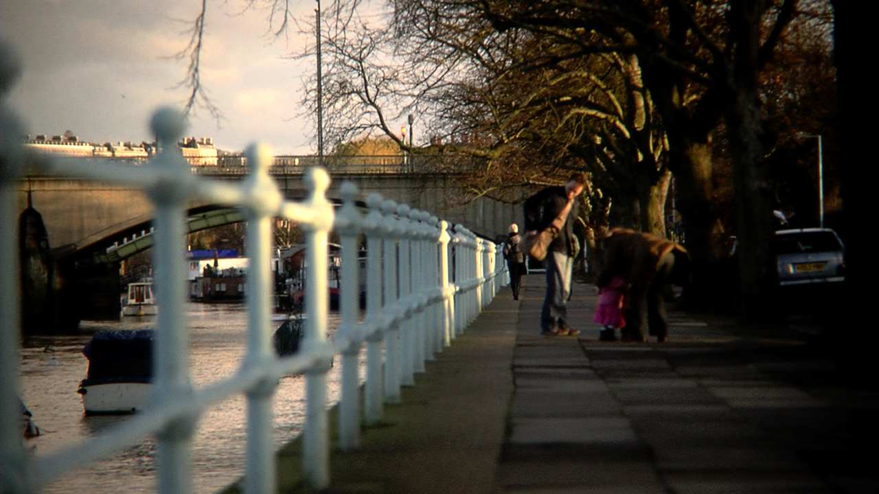

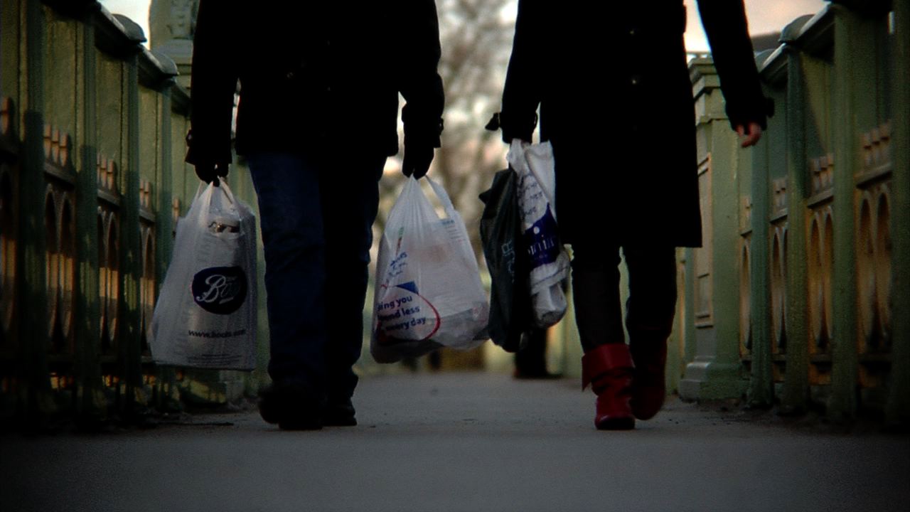

can you post a still image from your camera showing the noise.
I think my HD100 shows more noise than expected.
Ta
Andrew
Drew Curran is offline   Reply With Quote
Old February 14th, 2007, 06:25 AM   #38
Location: London UK
Posts: 1,939
stills
couple using the 35mm adaptor which help show up the noise better (the adaptor itself doesnt create noise) and a clean shot. You can see it clearly in any dark areas.
JVC HD 201 and 35mm adaptors-still.jpg   JVC HD 201 and 35mm adaptors-still2.jpg

Phil
Looking at your images, I often see similar noise levels on footage from my HD100 - especially in available light situations.
Its harder to spot when more lighting is added.
Andrew

yeah...it isn't really acceptable as it is
