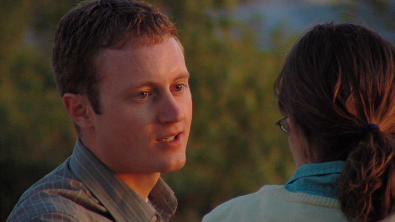

HD100 noise
Phil, I have noticed a fair bit of noise coming from my HD100 as well but only in certain conditions. Attached is a pic from a shoot at sunset. This is the worst it has been at 0db. I find that low light + red/orange light is what triggers it. I've been quite satisfied with the imagery otherwise and on most other shoots.
(This shot is with the stock lens)
That is really bad! Totally unacceptable on an HD camera. Has anyone else got examples as bad as this?

It may have to do with the color profile you use. I think I was using Paolo's TC3, but I'm not sure on any specifics. I know I have since turned down the red gain from where he had it and have not noticed anything quite this bad since. FWIW
Ok, you can shoot me if you like, put bare in mind I'm a producer not a camera op or DOP.
Can you define in the picture posted what aspects of it you consider to most highlight 'Totally unacceptable' noise, and how this is going to affect the average viewer?
When answering this - bare in mind that I am looking to shoot a narrative feature film with the P&S Techniks on the HD200/250, renting proper 35mm primes.
Originally were looking at using the HD100, but are now considering the HD200/250 so we can get full 60P in HD for slowmo shots, and a couple of other things.
The film is a thriller, will be lit in a controlled environment but also is likely to have spots of high contrast from light to shadow.
I'm just trying to gauge now whether what you are describing is a genuine massive flaw for the camera for it's intended purposes, or if it's just proving to suffer more noise than expected in certain environments.
