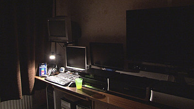

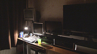

I read a bit to fast but now I see you zoomed both camera's in during your low light test and the bigger sensor fx1000 might have an advantage in that case. Is it possible for you to check again with both camera lenzes fully wide with the iris wide open and then set the gain on the pana at 30db and then see what gain value you get on your fx1000 if you match the exposure on both camera's?
I just tested with my father's fx1000 and my cx730 and 15db gain on the fx1000 equals 21db gain on the cx730 and 21db gain on the fx1000 equals 24db gain on the cx730. I attached a framegrab at those values. The cx730 could keep up with the fx1000 at it's highest gain value but was MUCH cleaner. At 24db gain the cx730 switches to a 1/25th shutter so it might not be a fair comparison as the FX1000 was at 1/50 but the image from the fx1000 was allready unusable at 21db gain and the cx730 can be used, switching the shutter to 1/25 on the fx1000 wouldn't do the image any good at 21db gain. The fx1000 was a bit sharper as at those high gain values the image from the cx730 gets softer.
Old December 1st, 2012, 03:30 PM   #10
Location: Belgium
Posts: 9,512
Re: AC90 Sample Footage
framegrabs here: (it also shows the difference between a 29,5mm and a 26,5mm lens as it is comparable to the ac90.)
AC90 Sample Footage-a1_cx730-21db.jpg   AC90 Sample Footage-a2_fx1000-15db.jpg
AC90 Sample Footage-b1_cx730-24db.jpg   AC90 Sample Footage-b2_fx1000-21db.jpg

730 looks darn good, amazing what these little cams are capable of.

I agree, like my framegrabs show the fx1000 is equally sensitive at very high gain values but has a unusable image. But the reason why I asked Tim if he could check was to see how the pana ac90 compared to my cx730 in terms of sensitivity. As he and I have access to a fx1000 I could somewhat compare and have an idea before I made a purchase.
For me it's important to have a camera that can cope with low light, not only it should produce as less noise as possible, which the ac90 has covered, but if it would be on par with a fx1000 at 9db, which it appears to do when at 30db that would barely be sufficient, but could work for me and still be much better then my xh-a1 that get's plain ugly at anything above 6db gain.
I just wanted to know how it compared when the lens was not zoomed in and in Tims test both camera's where zoomed in where the fx1000 might have an advantage. My cx730 lens ramps when you zoom in and looses low light sensitivity very quickly, so it's not an ideal camera to zoom in dark areas but that is something I don"t expect, I just want it to perform when the lens is wide open.
