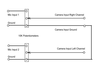

Sorry to change the subject but I have requested eBay to return this mixer ... Maybe I have the wrong idea but as far as I am concerned I want one mic to feed into the left channel (with a level control) and the other mic to feed into the right channel (with a level control) This unit sends the output from each mic to both left and right which is useless to me ..if you unplug mic one the output from mic 2 is recorded on both the left and the right channels which is useless to me !!
How do you envisage a mixer into a stereo camera input to work .. I really cannot see any point of mixing the mics together and then sending both combined signals to both left and right channels. If a mic goes faulty or is picking up hum/bad signal I need to be able to discard that channel in my NLE and with this setup if mic 2 goes faulty or has hum it will combine with mic one and ruin that too.

Actually that mixer splits the output so you can send one output signal to the camera (still both channels) and another to your Iphone (again left and right are mixed) What their so called "fancy" mixer is really doing can be done with just two resistors. I have a feeling the Beachtek unit also mixes the two incoming signals and places the mixed signal on the left and right tracks not individually but mixed.
I think a very simple passive circuit might just work here ... send mic 1 into a potentiometer and then feed the signal into the camera's left channel and do the same with the second mic input ... each goes to just ONE channel in the camera so if one mic picks up garbage it's not mixed with the other mic signal.

My feelings exactly Chris, all you need is two straight ins and outs with probably a 10k pot in each line for a simple passive two mic system and a very basic pre amp on both lines if you wanted it active. You could even parallel both outputs to a third stereo output with a switchable socket that only parallels them when you want to mix both together and plug a lead into the socket.

My circuit exactly but without the "combine" switch ..This just sends mic 1 to the right channel and mic2 to the left channel and the 10K pots give you some attenuation control in case one mic is getting input from a loud source like a PA system ... At full volume the 10K resistance should give you unity gain as this a passive circuit. It works just as I want it to with a handful of cheap components .. I'll drop the controls into a little plastic box with graduated knobs now and it will look OK.
I realised that I don't need a headphone jack either as one exists on both receivers!! Plus the camera also has a level display.

That's exactly how I see it Chris, so good luck returning the mixer and post a pic when you have built your own:-)

If you make your own and want to have a switch across the left and right outputs to feed both mics into the camera mixed you will just have to also add a 47K resistor from each pot wiper (centre terminal) to each output so they mix correctly!
I have a shoot in the morning here and my electronics shop is on the way back so I'll pick up the hardware tomorrow and assemble it!
