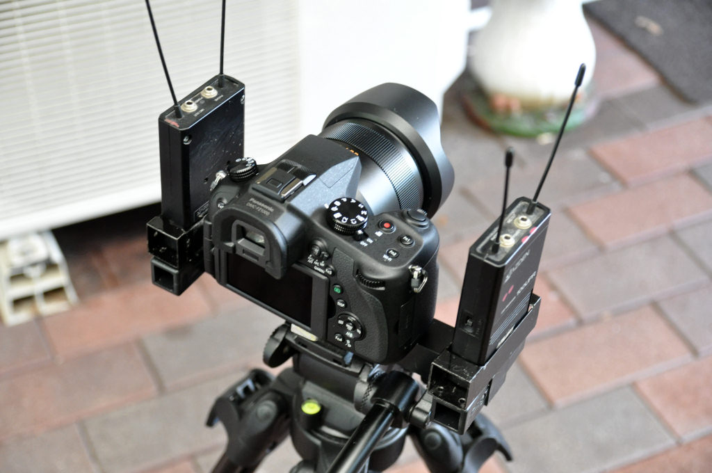

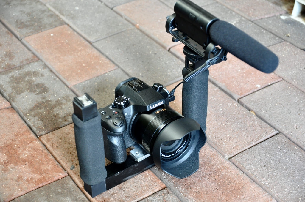

I have finished the mini frame for the first camera. All it is, is a 180mm piece of 25mm square aluminium tube with a "T" shaped bracket to attach the camera in the centre. The bracket shape allows me to still access the battery cover without removing anything which is handy! It has two pieces of the same tube left and right that go up 120mm and have foam bicycle grips on each for some extra stability and on top (each side) I have a cold shoe. One for a light when I need it and the other for a Rode mic. I put the mic on the side so I can still use the EVF ..if on the camera's hot shoe the back of the mic sticks into my forehead!!!
The second mini frame (in construction at present) is the same except I have an extra plate on the aluminium tube with my QR tripod plate on it ..either end will have mini pillars with trays that fit the receivers on each side and I should be ready to go!! I'll put the mixer on the camera shoe !

Here is my A-Cam frame that takes the wireless receivers ..it still has to have the little mixer on top of course. Also my B-Cam frame which is much the same but will be my handheld camera so it has the tube up each side with cold shoes on each side (one for the mic and one for a light if needed) The mic here is my spare el-cheapo as I'm still waiting for the Rode to arrive.
The last thing I have to do is organise and re-balance my stedicam but it has a 7" monitor on the bottom stage and the dealers want $30 for the AV cable cos it has a special plug ..since the cam has a visible LCD I might just scrap the big LCD on the stedicam and just use the cameras LCD .. saves me having a another battery to remember to charge up!!

Ready for action then Chris :-) I like the idea of the handheld frame with the space for mic, light etc. Are you still able to use the LCD screen? The tripod frame looks to do the same sort of job as my double tripod plate, mainly take all the bits that don't fit on the camera. Nice to make your own custom built one though.

It took a lot of thought, build and re-build but yes the LCD on both is fully extendable so it clears the frame in all positions .. as does the mount to the camera which allows both battery and SD card access without having to remove anything .. I didn't want to have to unscrew/move stuff to be able to have full access. A mic mounts perfectly on the centre shoe but you cannot use the EVF .. maybe the Rode VM Pro might have it's shoe far enough back to not dig into your head..but I have a Rode Video mic and even on the rear mount it still protrudes. I find that it's easier to have a handle either side with the camera otherwise I tend to hold it with my left hand under the body.
