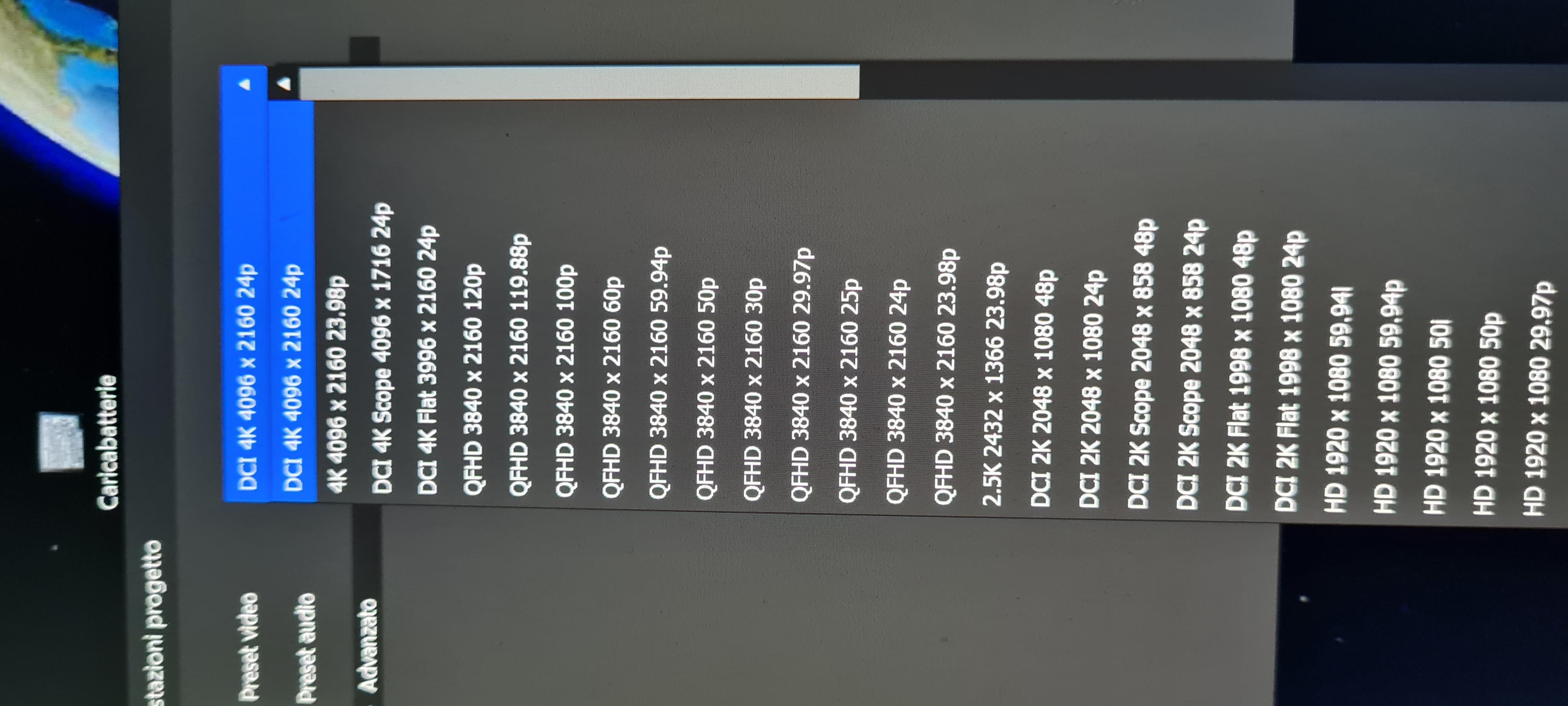

I thought about ProRes only because I know it is easy to do video editing.
I don't see the 5.7K Preset with 50P in Edius 9. I see 4K 4096x2160 24p. Look at the first pic.

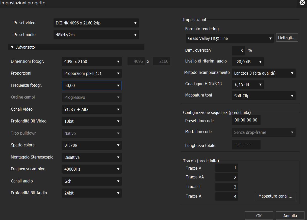

Could you check the second pic and tell me if I have to config. Edius 9 in this way and if it is the right config?

That is the limit for EDIUS 9WG. EDIUS X does go to 8K. But why do you want to do that. For your TV surely you would want 3840x2160 and that is there at 50P in EDIUS 9WG. I would even see editing at 1920x1080. You can then always render at 3840x2160 if you want to do that. Beauty of shooting 5.7K is you can use layouter and move around the image or use the full image.
