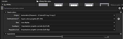

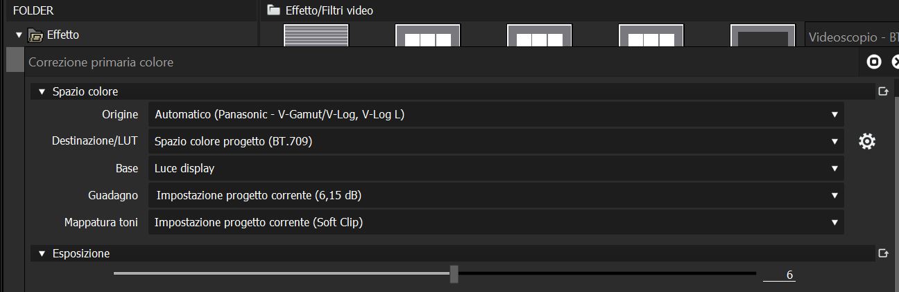

Hi, I would like to start using the V-Log well with my GH6. I have already done some tests and it seems a good profile for my doc anche that give me some satisfaction. But I don't know if my GH6 settings are right.
Now I write my settings:
3840x1260 50p
4:2:2 / 10bit / AlLL-I, LPCM 600 Mbps
ISO 800
Luminance 0-1023
Do you think something needs to be changed?
Is the Edius 9 Lut by default good, or is there something better?
Thank you for your welcome advice because I have never used V-Log and I would like to learn better from someone who has more experience than me.

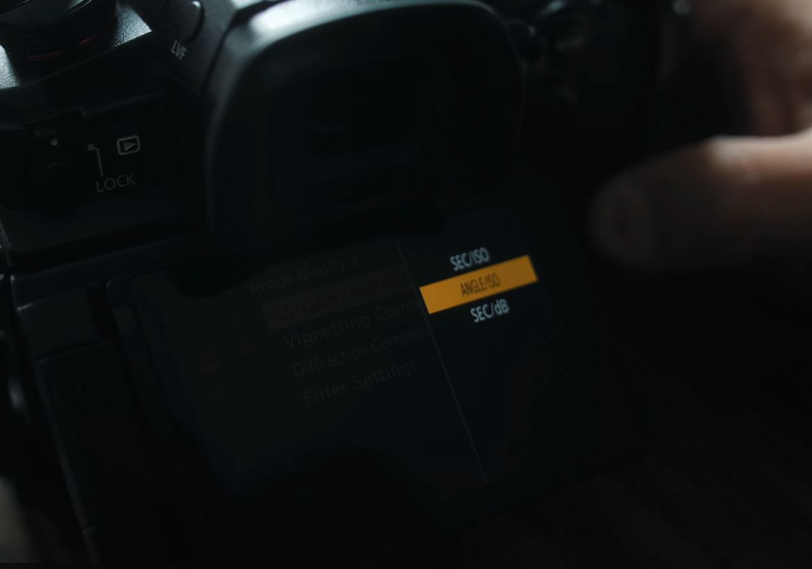

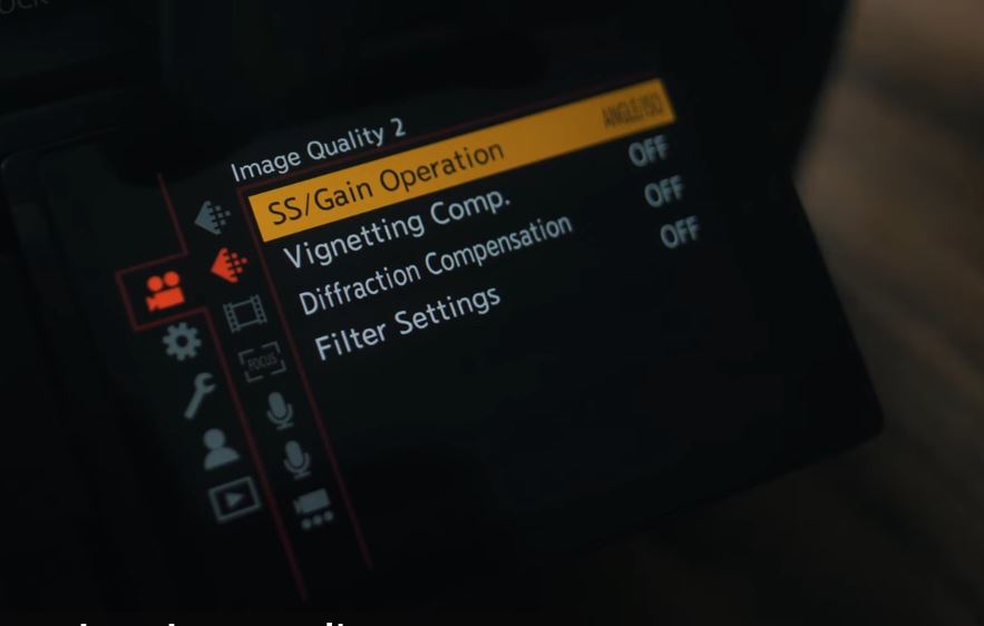

EDIT: In your opinion is it better to choose Angle/ISO in the GH6 Menu?

All i will result in much bigger files but maybe easier to edit. However for you that would mean using 3 times the number of cards when you travel compared to 4:2:2 10bit LongGOP at 200 Mbps. I think your computer will play those 4:2: 2 10bit files? Try first. Personally I have moved to using Resolve as I find on my PC it is much better. I use colour management in Resolve so no need to use a VLog Lut's at all. Of course PCC in EDIUS does not use a Lut either but corrrect the color space like Resolve but for me not as well. Turn on the internal Vlog lut for the LCD so that you can see what the end image will look like.
It is personal view of if you set angle/iso. If you are switching frame rates often, especially slow frame rates, it is handy. Personally I always shoot 60P so I usually leave sec/gain .
I would learn from looking at some YouTube videos and using yourself as Vlog is not straight forward to use and will need you to pay attention to exposure levels maybe a lot more than you do now.
I would really like to find something on the Internet/youtube to understand how V-Log is handled with Edius. I'd like to see some examples of how to manage colors. But on youtube there is NOT anything or almost nothing about Edius and V-Log. What a shame. I would like to learn how to use Edius 9 better but I don't know where to look.

Old April 14th, 2022, 01:45 PM   #11
Join Date: Mar 2003
Posts: 4,222
Re: Pana GH6: problem with AF
EDIUS converts fine by just applying PCC filter to clip. Nothing else to do. The rest you may want to do is just like any normal corrections to levels or colour you may want to apply. More important is how you expose for Vlog when shooting. I believe there is a lot of videos on shooting Vlog. Just look. You do not want to under expose as when you bring the levels up you will have noise in the shadows if you have under exposed.
Dealing with Vlog files is a lot easier than shooting Vlog.
