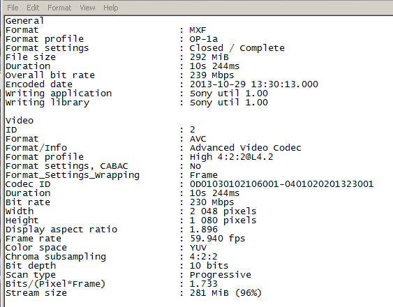

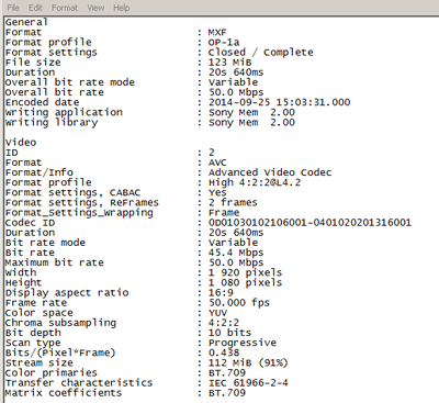

I have tried importing and dragging all flavours of XAVC files into various NLEs. With the 230mbit XAVC-I MXF files from the F5 / F55 I have no issues. Also no issues with the 8-bit XAVC-S files that are wrapped as MP4s such as those from the Sony A7S. Where the problem appears to lie for some of us is with the newer 50-mbit XAVC-L MXF files from the PXW-X70. It is these Long GOP files that are proving very hard to read. I have tried reading them with the latest update of Premiere CC and Avid on Mac and Vegas and Avid on PC and all to no avail.
Upon analysis of earlier XAVC MXF files I find that all previous iterations have been written with Sony's writing and library application called
'Sony util 1.0'
Whereas these newer XAVC-L 50-mbit MXFs from the X70 have been written by a new Sony writing and library application that I haven't seen before and it's called
'Sony mem 2.0'
Why Sony has made changes to the writing and library app is unknown. I guess they have a good reason for doing so. There are other significant changes in the file structure of the two MXF flavours such as CABAC and Format_setting_wrapping as can be seen from the attached JPEGs of the file info’s. Until such time as Sony releases the details for these proprietary libraries I don't see any hope of any resolution coming quickly. By all accounts Edius manages to read these files with no issues. Maybe they have a hot line to Sony's software team.
It does make we wonder if this issue is going to appear with the release of all the new XAVC-L MXF capable cameras such as the PXW-X160 / 180 / 200. This could get interesting if it's not sorted pretty quickly.
