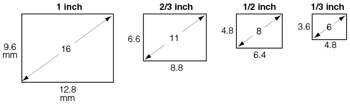

Those with the camera, in real world usage are you finding the 1" sensor @2.8-4 really gives shallower depth of field than a 1/3" sensor that is 1.8-2.8 or so?
In one word the answer to your question is, yes in the real world you do notice the difference in DOF. Why is this so one might ask?
A brief explanation if you will indulge me.
A 1” sensor has a diagonal dimension of 16mm. A 1/3” sensor has a diagonal dimension of 6mm. The crop factor of your 1/3” sensor relative to a 1” sensor is a factor of 2.6666 recurring. This is arrived at dividing the 1” diagonal by the 1/3” diagonal. 16 divided by 6 equals 2.6666.
This calculation is also relative to aperture. If your 1/3” camera was at f1:1.8 the depth of field at, let us say 10 feet, would be the same as the depth of field on the 1” sensor at f4.7998. For the sake of brevity let’s say f4.8. You multiply the 1/3” sensor aperture by the crop factor to arrive at this result, e.g. f1.8 x crop of 2.6666 = f4.7998.
In short yes your f2.8 aperture on the 1” sensor will give you a shallower depth of field than f1.8 on your 1/3” sensor.
For a far better and more accurate, and probably simpler explanation than I am giving here on aperture, DOF and the influences that sensor size has on these aspects of image one should have a look at sites like this:
Basic Photography Tutorial - DoF: Aperture and Sensor Size
Notes on crop factors, DoF and FoV - www.similaar.com
Digital Camera Sensor Sizes: How it Influences Your Photography
Chris Young
CYV Productions
Sydney
Sony PXW-X70 announced: Pro XDCAM version of AX100-sensor-dimensions-01.png

Thanks for that explanation, and yes, I was just wanting to know if the difference was really enough to notice in real world use :-)
One thought - given that, for now, the X70 only does 1080p, does it shoot using the entire sensor and downsize it in-camera, or does it actually shoot using a crop of the sensor? And, does this make a difference on DOF?
And when the camera does 4K with the same sensor, will that have any effect on DOF?
Thanks again for your insights on this camera - I just pointed someone on another forum to this one for ideas on settings for the camera.

"One thought - given that, for now, the X70 only does 1080p, does it shoot using the entire sensor and downsize it in-camera, or does it actually shoot using a crop of the sensor?"
No it does not crop so no DOF difference. The HD image is sub-sampled down from the effective 14.2 million pixels of the 4K sensor hence the sharp image. Too sharp in fact for certain subjects. Especially older people's skin or beautiful young things with skin blemishes. Outdoors and cityscapes etc look fine with the stock auto detail setting. Don't forget the x70's detail circuit is a dynamic thing and that the camera uses automatic optimization for detail setting depending on what it thinks is best at any given setting.
