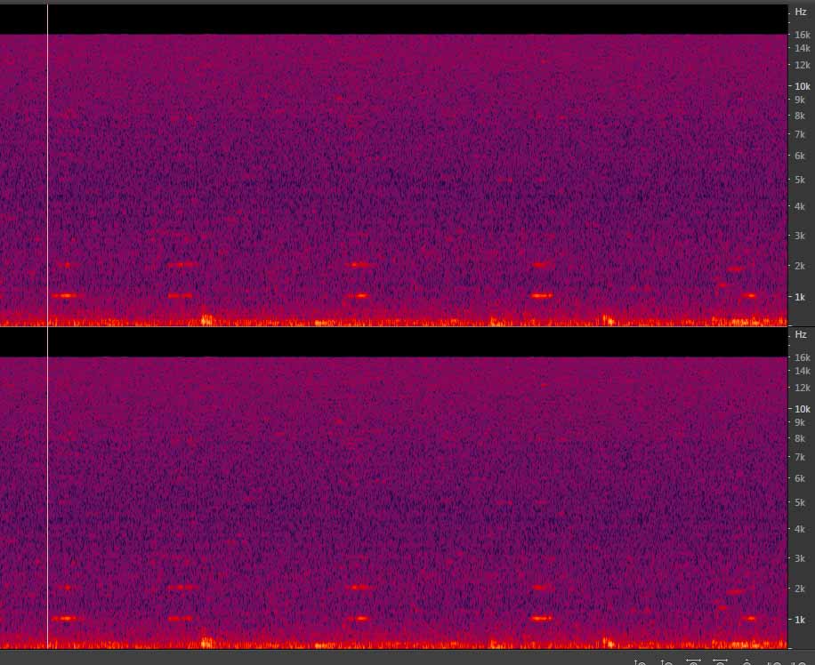

Withh regards to David's first video above titled "Sony PXW X70 audio beeping", I've isolated out the beeping.
First thing to note (forgive the pun) is that there are two tones at work, on the 1khz and 2kz frequencies.
A visual spectrogram of the cleaned up-ish audio is attached.
You can download a finished .wav sample file from http://www.filedropper.com/pxw-x70beeps
Andrew
PS. It really does sound like a heart beat monitor for your camera. At least, that's what came to mind.
Sony PXW-X70 announced: Pro XDCAM version of AX100-pxw-x70-beeps-visual.jpg
