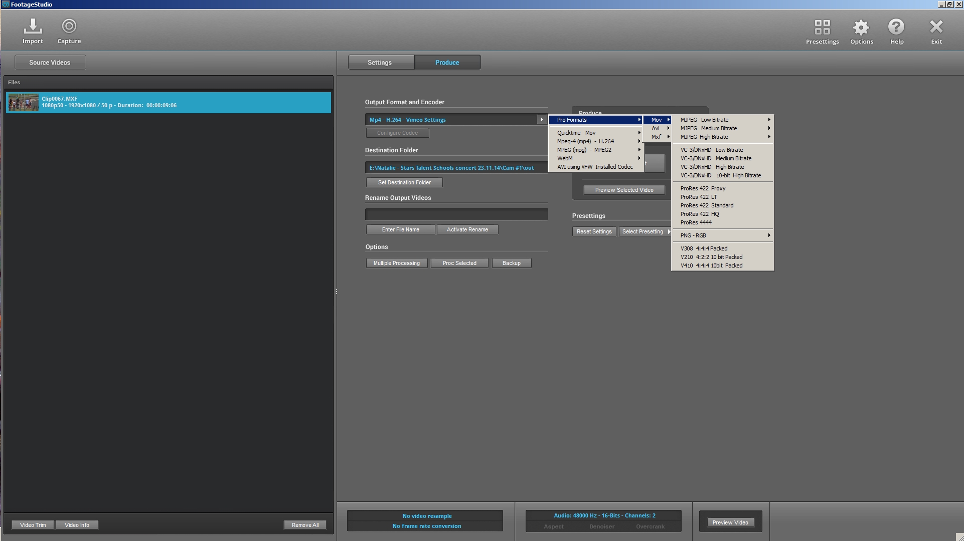

I know for a lot of you have had issues decoding and converting the Sony XAVC-L 422 10-bit long GOP that comes with the X70 and some of the other PXW cameras. Well there is a bit of light on the horizon.
I have been dealing with a guy named David on the Acrovid support team. Acrovid are the authors of FootageStudio4K. I sent him an XAVC-L clip a while back. The upshot is that he has got back to me with a download link for a trial version of FootageStudio4K that actually handles this codec beautifully. It can batch convert to many different codecs / wrappers etc, including many 'professional' codecs. This really opens up a new avenue for those of us stuck with nothing able to decode these files.
Early days so far but I am having great success in converting these XAVC-L clips to ProRes. What I see I like. Unlike some ProRes conversions FootageStudio4K appears to be maintaining the correct IRE and gamma levels of the original source footage.
I've attached a JPG of the interface GUI.
This is the gist of David's reply to me:
"I just uploaded a new update with support for Sony XAVC format, your sample file is processed fine, when processing you can also remove the empty audio tracks by unchecking them in the audio tab or in the trimming dialog.
you can download the new update 1.0.76 from Acrovid web or directly from here:
http://www.acrovid.com/downloads/fs4k64t_setup.exe
Please note that actual version implements most filters in 8 bits, so if both input and output videos are in 10-bit, the video is converted to 8 bits for processing. The 16 bits conversions actually implemented are the direct transcoding, and video resample, this is, if you activate the video resample and both input and output videos are in 10-bit, then the resampling is done in 16 bits keeping all the quality.
We are developing the full 16 bit processing version and I think will be ready in about 1 month, and of course it will be a free update for registered users."
Give it a go folks. I would love to hear your experiences with it. Use the link David supplied as the website still has the previous version which couldn't open the XAVC files.

That's an awesome responsiveness from the software developer. Credit where due.
Look forward to some feedback.
Chris Young
CYV Productions
Sydney

David is meaning that the code base being written is able to be 'ported' to Apple. Very much like when in 1998 Macromedia's QuickTime based NLE for Windows which was called Final Cut was 'ported' to Apple and became the ubiquitous Final Cut Pro we all know about. We just have to wait.
In the meantime I'm waiting on a response as to whether a purchaser of the Win version could eventually transfer that licence to a Mac version in due course.
Currently the Win version does a nice job of batch conversion along with a host of options like De-noise and a host of filters like:
Enhance
Add Motion Blur
Remove artifacts
Add grain
Convert PC/TV output levels (This is a great option to have)
Color space conversion
Convert to grayscale
Flip video
Swap chroma channels
I'm about to check out FS4K's Overcrank / Slow Motion capabilities which have a number of motion processing modes including pre-processing. Should be interesting.
