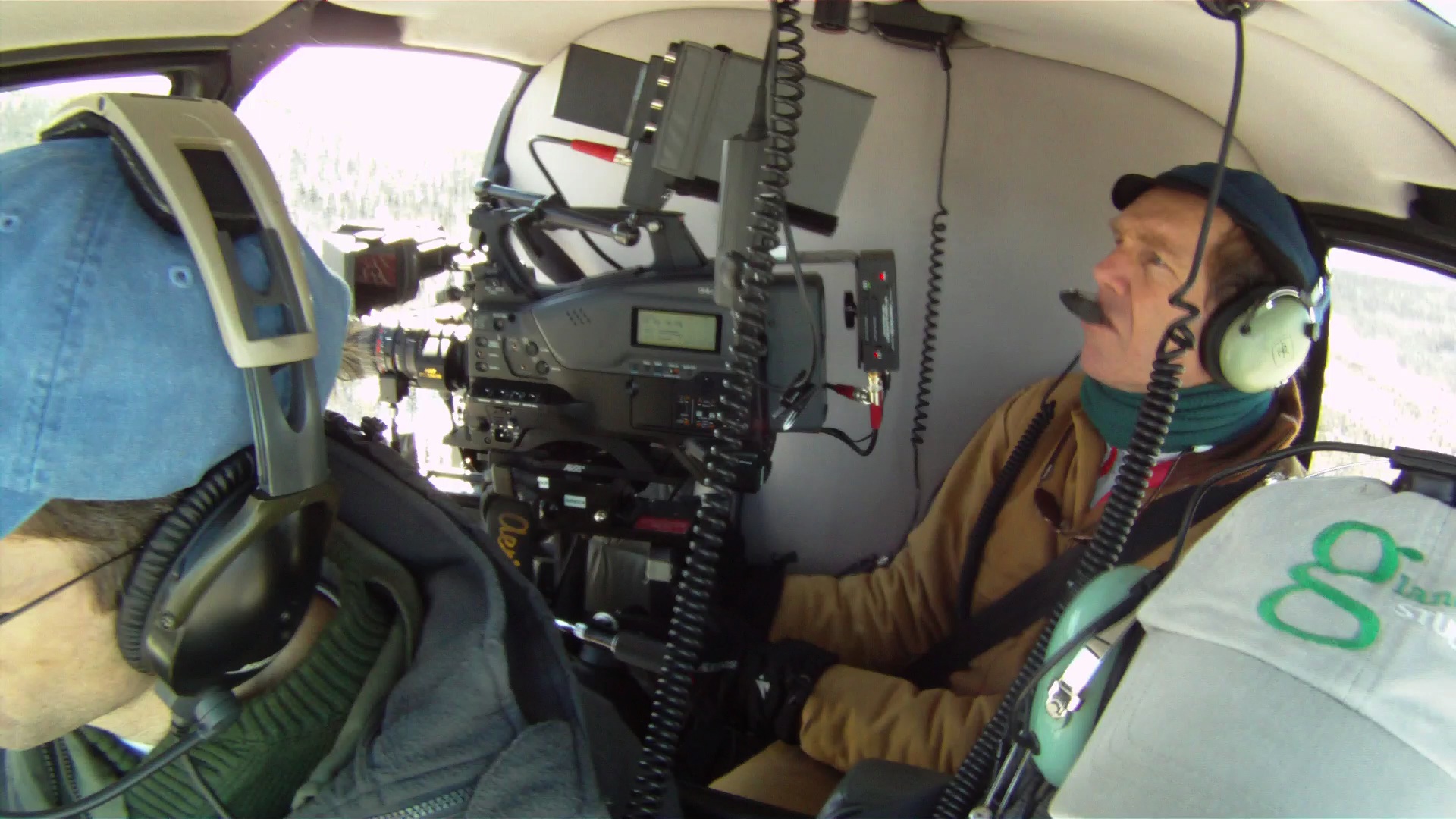

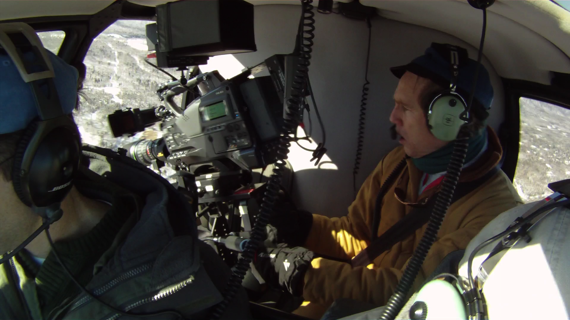

Lens is working out well. Here is a still taken from my GoPro POV suction cupped on the inside of the windshield last Friday. The GoPro bounces all over the place and as you can see does not handle the highlights well but gives you an idea of my setup and shows the ZA with focus control.
Second shot better on the highlights but the focus is not sharp, but again just to show the set up.
