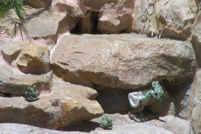

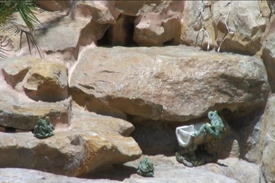

HD to SD Grabs (Vdub vs. A1u downconvert)
I know some of you are wondering if down convert in the A1U is worth anything. Below are two grabs. One is a grab from the Premiere Pro 2.0 after capturing from the A1U using the downconvert option. The other is a grab from a simple workflow from Premiere Pro 2.0 to VirtulDub 1.6.19 and back into Premiere Pro as SD 16:9.
Grab Labeled VDUB workflow:
Captured in PPRO 2.0 as 1080i HD
Exported as uncompressed Microsoft AVI 1440X1080i
Imported to VDUB
Exported from VDUB resized to DV 16:9 uncompressed 720X480
Imported to PPRO 2.0 as DV 16:9 (interpret footage)
Export Frame
Grab Labeled DWNCONV workflow:
Opened PRO 2.0 project as DV 16:9
Captured with A1U set to downconvert (HDV-->DV)
Put on timeline and export frame
I did this with only PPRO 2.0 and VDUB, no HD plugins or Cineform.
RESULTS - You tell me. Seems like Vdub does a decent job, but the in camera downconvert looks softer...
